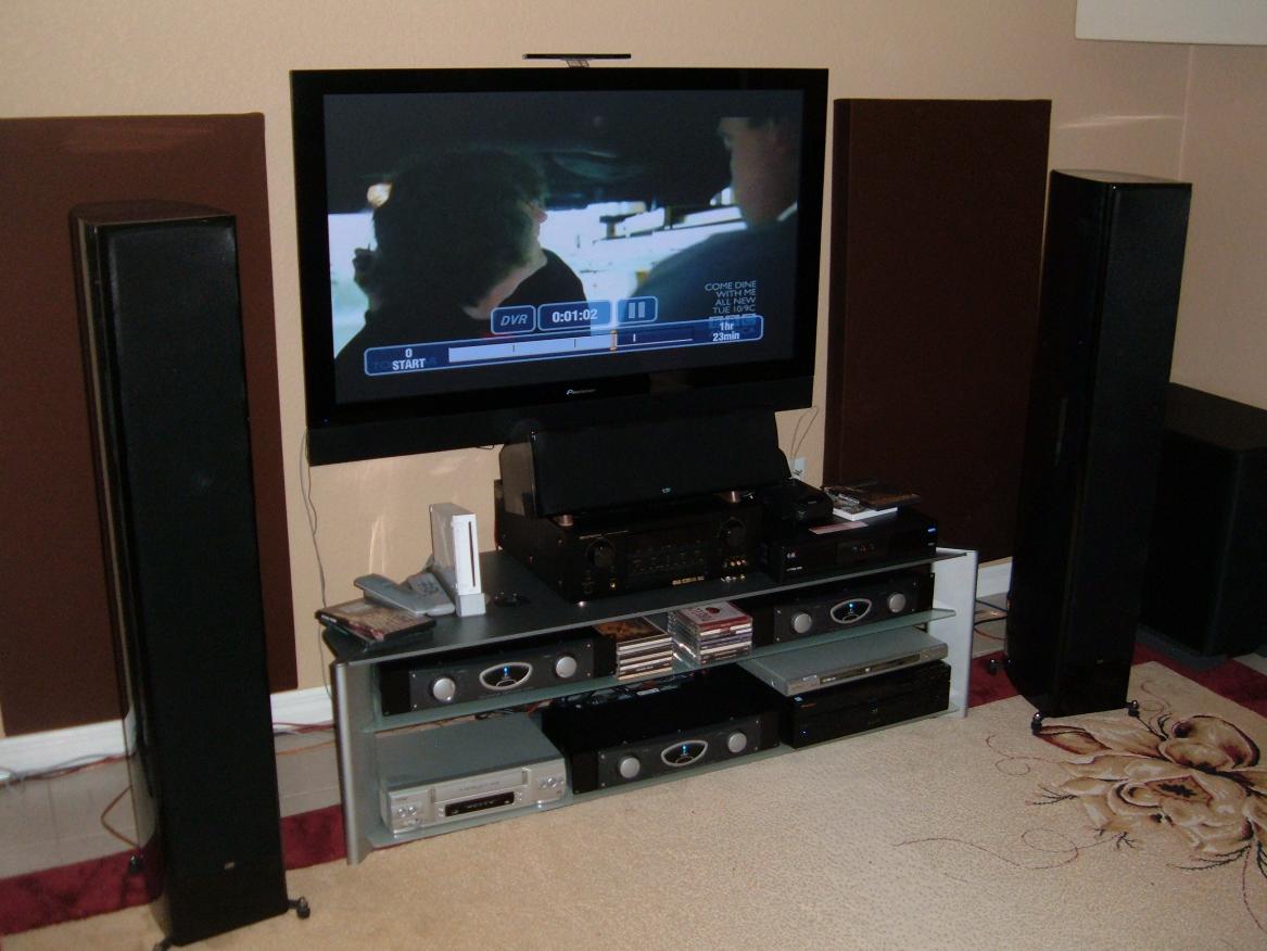

I accept the correction that they sound distant/Far away instead of close up. I will try to attach a picture to this post so that you may see how my lay out is.

Here is a higher resolution picture, the camera is a crappy one but it is better that my phone picture.

I spend quite some time last evening moving things around, took the sub out of the corner ( A bear to move) and move the speakers around. I moved them closer to the side walls- didnt help-and even tried them closer to the back walls, again not to my liking.
What I did not do is to bring them out more into the room, perhaps instead of having them 8 feet away, I may try 7 1/2 feet and see what happens.
I am hoping that I end up liking these speakers as well. The pictures that we see of them truly does not do them justice.
