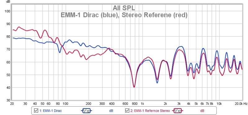

Well, if your Dirac measurements have been properly done then the range between 100 and 300 Hz is at least 10 dBs lower than the rest... if you consider that a much less "boxy sound" that's OK, I never debate on listening opinions being them so subjective.
Flavio
I followed the Dirac instructions...many times ;)
I will I remeasure with REW and OmniMic2 with the Dirac 9 positions separately with each speaker and ASIO. Then that will be my Baseline.

That's true, I missed that. I have taken numerous measurements with REW and minidsp Umik-1 and have never come across anything close to what you've got with yours.
I be doing some additional runs in the coming weeks.
The plan is to includeUMIK-1, EMM-6, and OmniMic2 since all have individual calibration files with FL/FW using the Dirac 9 measurement positions.
- Rich

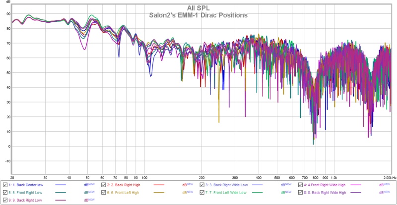

Here is a REW (Java driver) with both speakers driven.
The 9-Dirac positions were measured.
- Rich

Dear Rich,
the new graph above is different and it's hard to discriminate among the different speakers but if you look at the general behaviour you will see the same depression centered at around 200 Hz that is then followed by the same weird big dip around 800 Hz and a second dip before 2 KHz... than the graph stops at 2 Khz.
These large dips are shown exactly at the same frequencies as in your previous graph where the general behaviour up to 2 KHz seems to be the same (Stereo Reference red curve):
I'd guess that you would see the same following large dips after 2 KHz if you would look at your new graph but full bandwidth... if that is the case I would not use it as a baseline.
My two cents of course,
Flavio

I intend to do new measurements for a baseline with separate FL/FR speakers in the Dirac positions.
Here is the same REW measurement of the FL/FR speakers (Java driver):
These are the Dirac positions with the FL/FR speakers both playing.
The dip between 100 and 300 Hz is not present.
Since things get wonky aft 800 Hz, I will re-measure. Then, it will be a baseline.
- Rich

.... with the FL/FR speakers both playing.
Hi Rich,
the interference of the FL/FR speakers may create a comb-filter effect due to playing the test signal in both speakers at the same time
I hope this helps,
Flavio

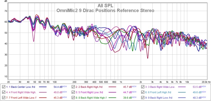

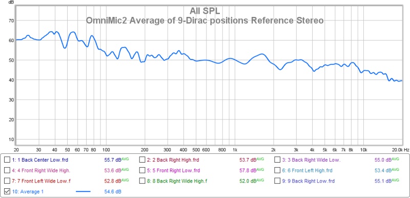

Here are some measurements taken of the Salon2's with the OmniMic2 and the XMC-1 in Reference Stereo mode. The 9-Dirac positions used in the article were measured.
The chart with all 9 measurements is reminiscent of the Twilight Zone (Do not attempt to ajust the horintal or the vertical). :p
The average of all 9 shows that there is no reason for panic. :D
It also lends credence to the subjective listening conclusion that there was no problem in the 100 to 300 Hz range that required correction.
- Rich

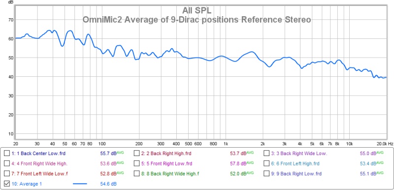

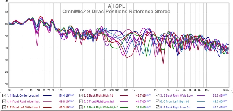

- Rich

It seems reasonable to me to conclude that OmniDirectional microphones are highly sensitive to location and somewhat erratic at higher frequencies (and sometimes are relatively low frequencies).
Large changes occur with small mic movements that don't seem to representation of what we hear.
The meaurements in Post 53 were taken at the same positions described in the article:
The measurements spanned a 3-foot wide by 14 inch deep area roughly matching the seating positions of my love seat. The low mic height was set to 38 inches and the high mic height at 47 inches. The 9 Dirac position measurements were then averaged.
Moving a mic just inches altered the measurements significantly. Do you hear these drastic (20 dB at 800 Hz) differences when you move your head a few inches? I don't.
If a mic, for whatever reason, is seeing a problem that is not heard (or possibly not present), then REQ will make a mess. Audyssey, Dirac, and others tell us that the purpose of multiple position measurements is to avoid optimizing 1 point. Another benefit may be statistical averaging to reduce the effect of mic measurement errors.
- Rich
