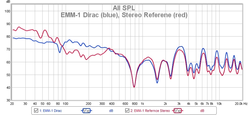

it looks like the REW graph has been measured with no Dirac correction above 3/400 Hz, if that is the case may be it should be mentioned.

The REW graph is using the default target curve (Full Range).
I can't account for REW's wavy measurement. Dirac shows much flatter response.
At any rate, when you compare the two curves, Dirac is making small changes above 370 Hz.

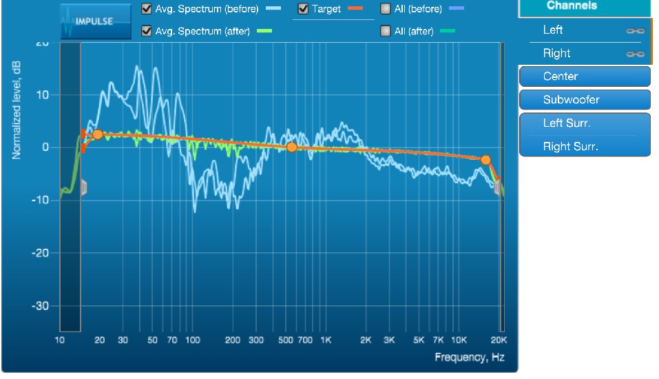

Dirac Measurement and predicted response:
Clearly, these two programs are producing different results.

REW is accurate also... but I have serious doubts about that REW graph if it is a full bandwith one (that's the reason I conjectured that the correction had been limited to the low frequencies)
First I doubt that Rich would be satisfied listening with the garbled response above 400 Hz of that REW graph BEFORE the Dirac correction.
Second I doubt that the AFTER correction graph is representative of a proper Dirac correction, if any.
In a few words no creative tech guys moved from Germany to Sweden :)
may be something went astray in that REW measurement.
At any rate, when you compare the two curves, Dirac is making small changes above 370 Hz.View attachment 16701
- Rich
That's weird, you saw my REW graphs several times before so you probably knew they were much flatter and smoother than the ones you posted, using 1/12 smoothing as you did.
First I doubt that Rich would be satisfied with the garbled response above 400 Hz of that REW graph before the Dirac correction.
Second I doubt that the after correction graph is representative of a proper Dirac correction.

My comment about VW was definitely tongue in cheek. However, the conflict between the measurements does beg further exploration.
When I managed a test lab, if we got conflicting results, best practices would be to to not release data until the conflict was explained/resolved. Sometimes, due to urgency, we had to release the data and followup with corrections as needed.
REW has been around a long time and has proven itself capable if the person running it knows what they are doing (and I believe Rich does).
Regardless, I hope some effort is made to determine why there is a conflict.
