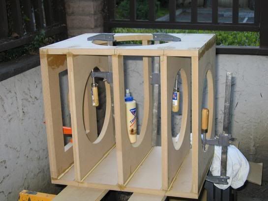

The Franken-SVS Plus that I built out of my buddy's old sub was down firing with a vertical PR as well. Not really sure how much it affects the sound, but that sub sounded pretty good.
U channel brace clearance and support for the active driver (that's the bottom facing up) and just normal hole for the PR on the side. He built it for a different driver then upgraded so I bought the box from him and dropped an old SVS plus driver and GR Research PR (which you can adjust using weights) with a Rythmik amp in it.

Dang John, I think that you are in the wrong business. You got skills my friend. Looks like it is built like a tank. I noticed that Emotiva is using HDF as opposed to MDF. Does that really make much of a difference? I am sure it is more expensive too. The PR functions like a port right? At least, that is how I understand it. The Physics behind it is fascinating to say the least.

That wasn't me. My buddy built that cabinet - he's good at it.
