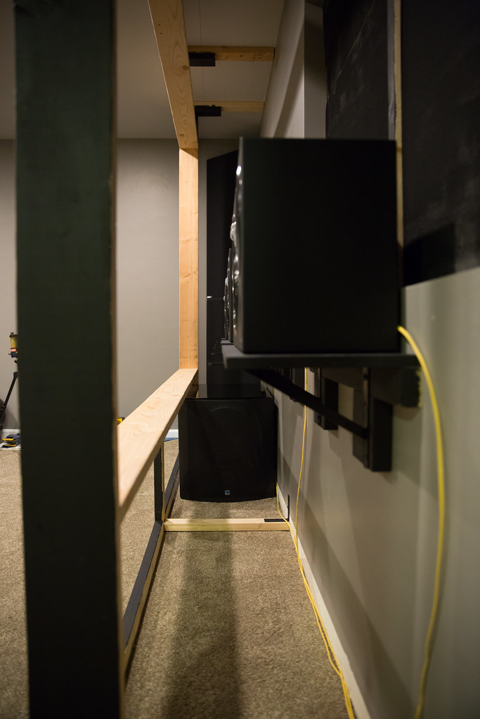

I currently have a single SVS PB-13 Ultra. There isn't enough room behind my AT screen to direct the sub drivers towards the seating position, so I have my subwoofer turned 90 degrees firing towards the center channel:
QUESTION:
I am now adding a second PB-13 Ultra, and was wondering if it would be better to aim the subs outwards opposing each other (but aimed directly into the bass traps) or keep them pointed at each other with roughly 4' between them. I know neither of these options are ideal, but I was curious if one option seems better.

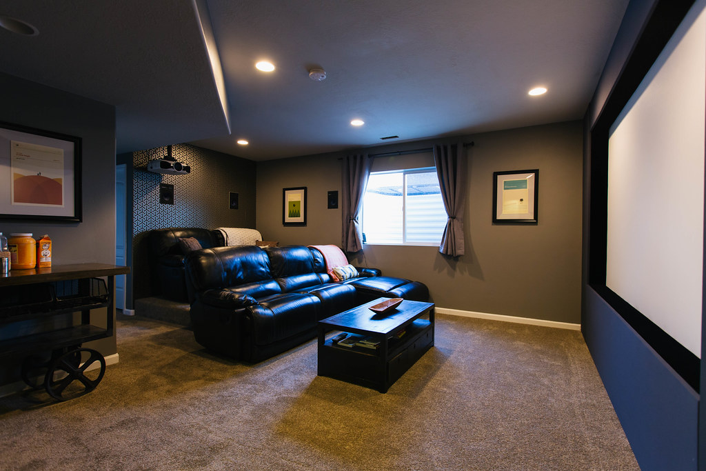

I just want to see some pictures of the whole room.

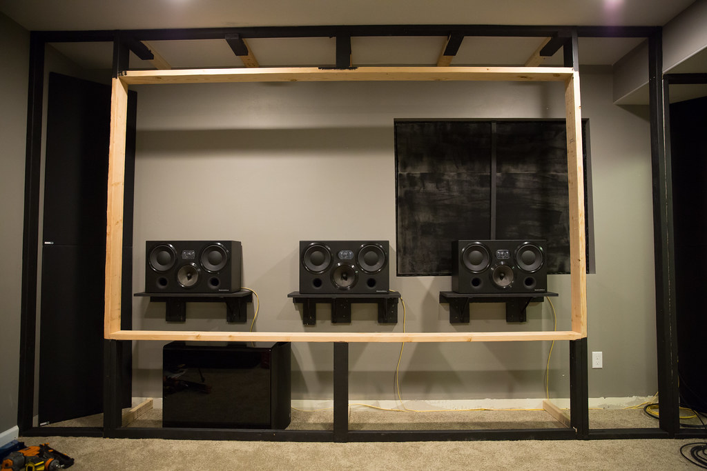

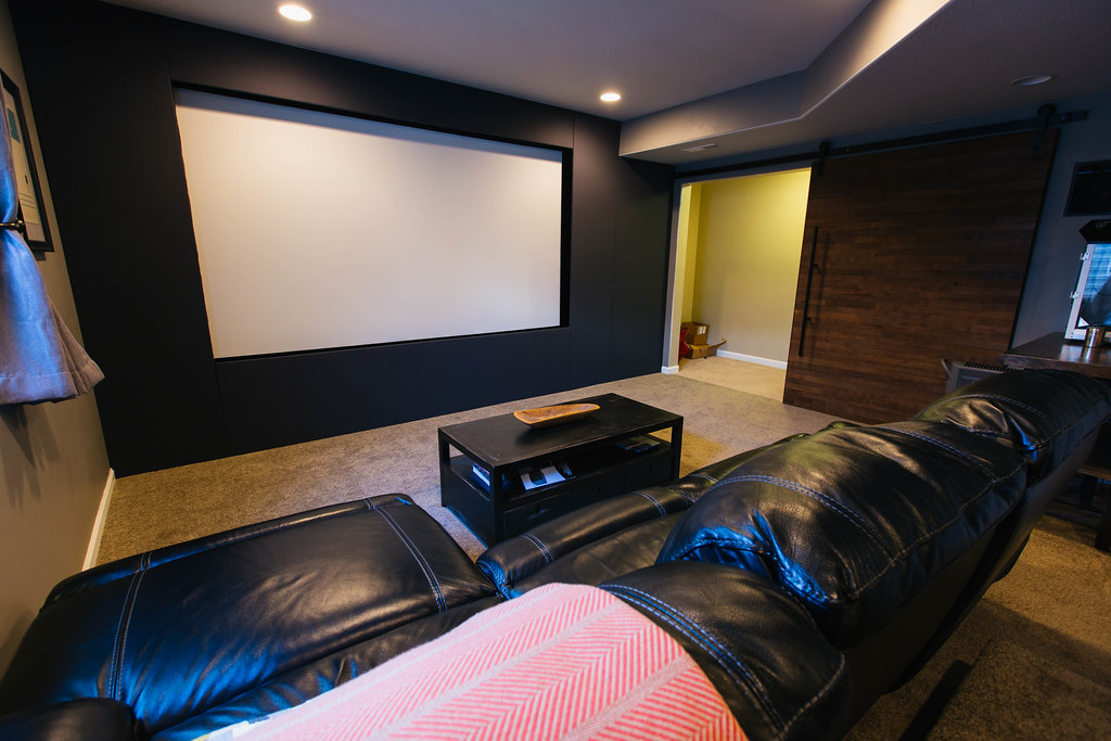

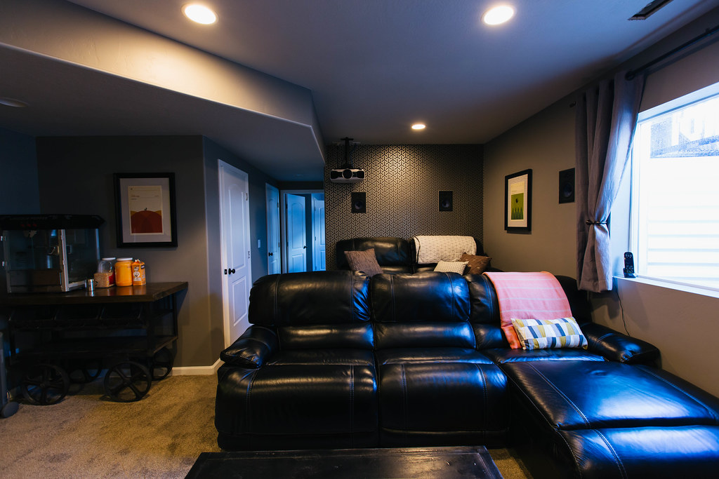

Thanks for the input everyone! I ended up measuring the subs in a few different positions, and centered firing outward seemed to produce the most even bass (although no where near perfect) for all seating positions. Still far from perfect, but I'm going to try to even out the rest with bass traps. It's an oddly shaped room, so unfortunately I don't have many other options.
Here are a few pictures of how the room came out:
