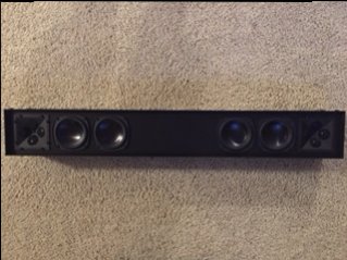

My budget is reasonably modest at $600. What is this soundbar on the picture?
It is a custom 2 channel James loudspeaker sound bar with the new quad-tweeter technology.
We use this with the James A2.1 amp.
