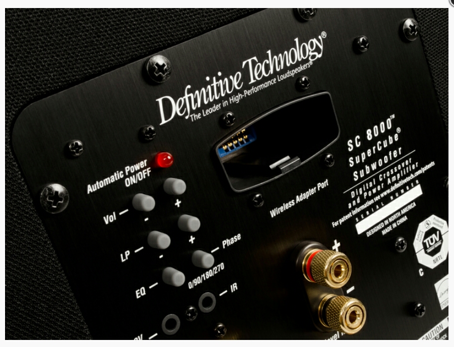

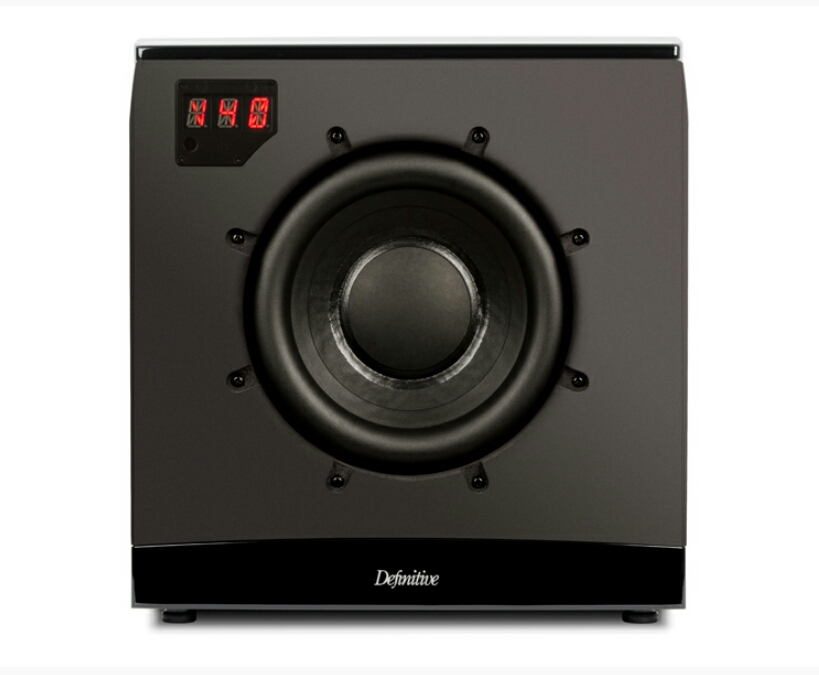

Buckle up for some thunderous bass! If you are a fan of Definitive Technology or if you are simply a bass fan, take a look at the SuperCube 8000. This sub, according to the company, features a designed-from-the-ground-up brawny Class HD digital tracking amplifier that is optimized for real world power demands to deliver low distortion and high output. This sub also has an integrated 56 bit Digital Signal Processor (DSP) which is, in essence, a mini computer–that is supposed to extend and improve the bass response. Multi-band digital protection systems tightly monitor and control the woofer system to prevent distortion and woofer damage at ultra-high volume levels with a minimum of audible artifacts. After all this information, you may be wondering about its power output rating? How about 1,500 watts? Check out the following specs!
  • Dimensions: 15-13/16" x 15-1/4" x 15-13/16".
  • 56 bit Digital Signal Processor (DSP) preamp stage.
  • All-new 1500 Watt digital tracking power amplifier.
  • Wireless connectivity (with purchase of optional SCW-100 wireless kit).
  • Performance Optimize Remote control for convenient and precise system tweaking.
  • High gloss lacquer finish complements any d'cor.
  • Quick, tight accuracy for full music enjoyment.
  • Explosive bass response for movies.
  • Disappearing alpha-numeric display.
Price: $1,299.00
Are you a fan of Definitive Technology? What do you think about this product?
