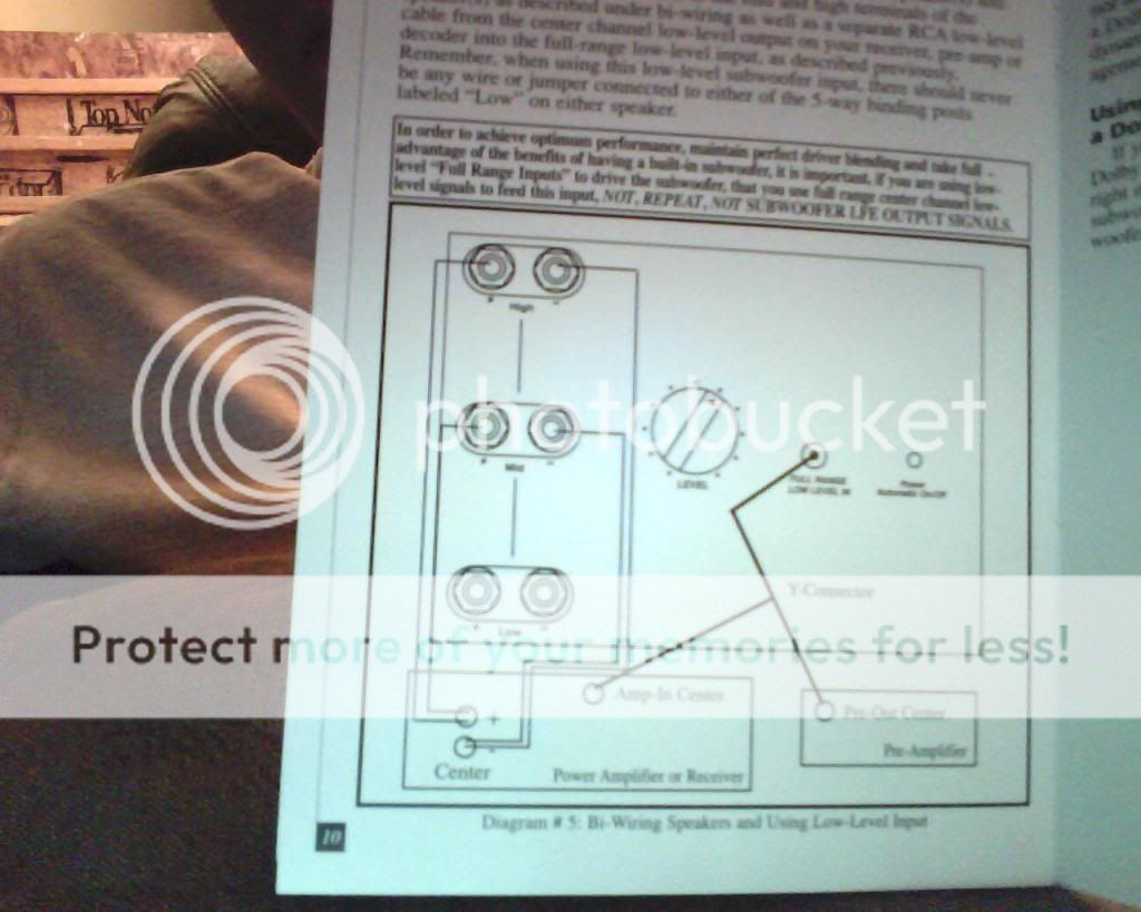

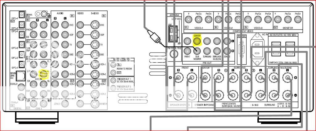

I have a Def Tec CLR2500 for my center and was going to try the "Ultimate hook-up" as described in the owners manual. It show to bi-wire the High and Mid post which I understand. My question comes in the "Full Range Low Level In". This is what the manual says: "If you dont have 2 sets of center channel low-level full range out puts (which i dont think i have), use a Y connector coming out of the center channel pre-out of your receiver or amp with one half of the Y going to the main center in of your receiver or amp and the other half going to the low-level input on your 2500". It also says that not all receivers have a low-level full-range center channel output and that I may not be able to use this hook-up method. By the way, I have a Denon 3805. I have attached photos of the owners manual and of the back of the 3805. I have highlighted the 2 Center in-outs that i saw. Are these the 2 inputs that I should be using or can i use this hook-up? Thanks for any help.

If you are NOT using an external Amp, you don't need any additional cables (Y-cables, etc.).
You don't need the Ext In Center.
Let your receiver's internal amps drive the center speaker (bi-wire). Then hook the Center Pre-Out from the receiver to the Full-Range Low-Level Input of the CLR2500.
