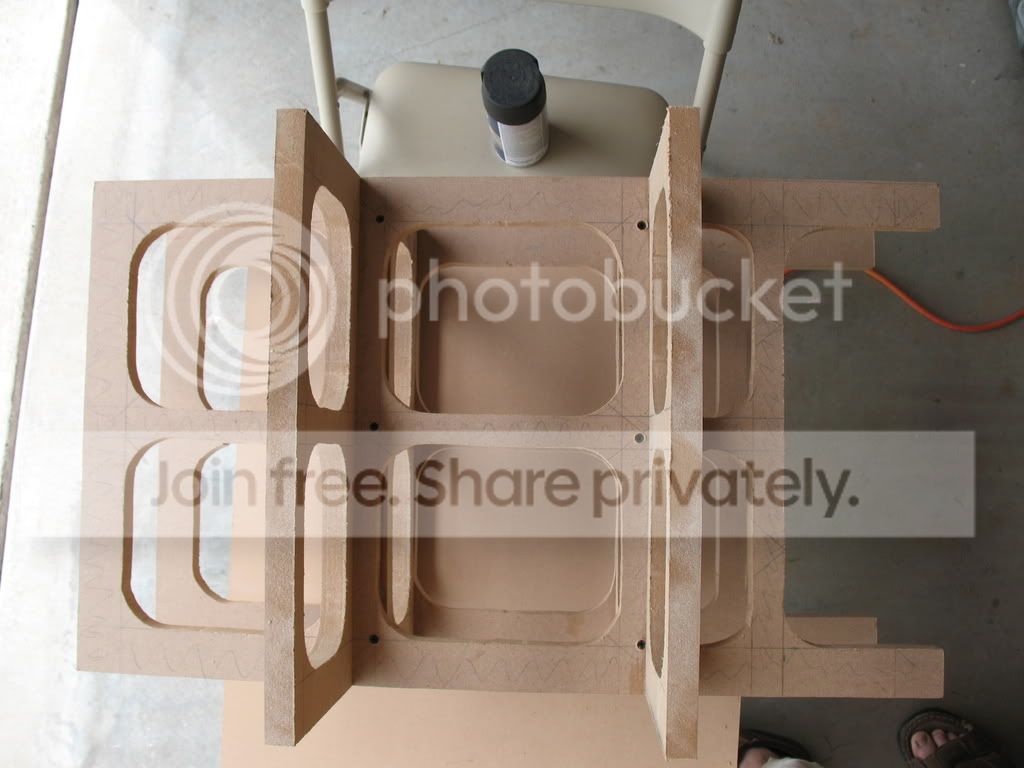

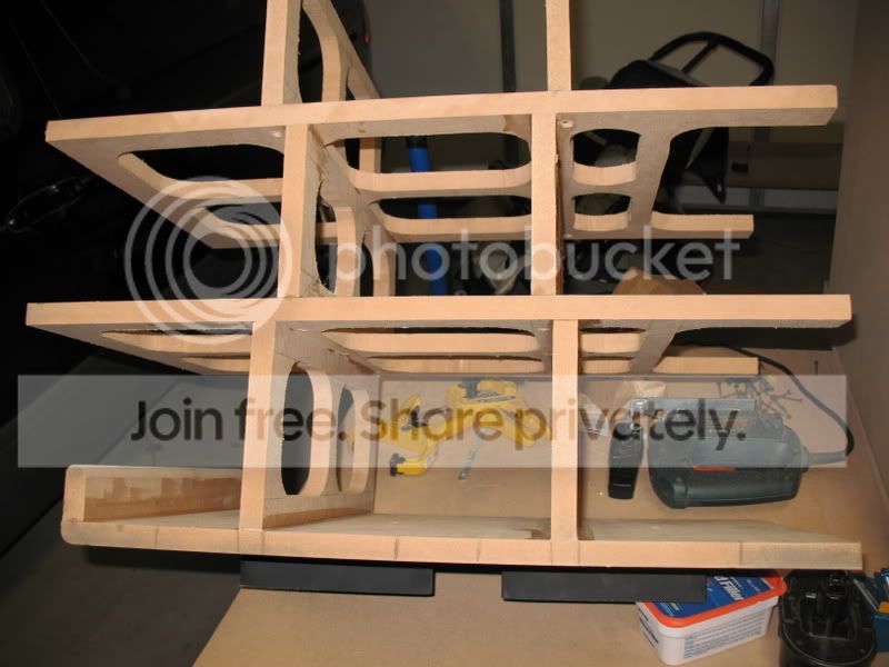

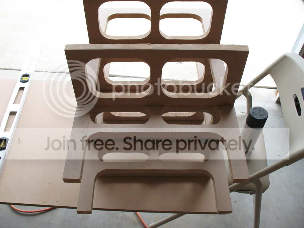

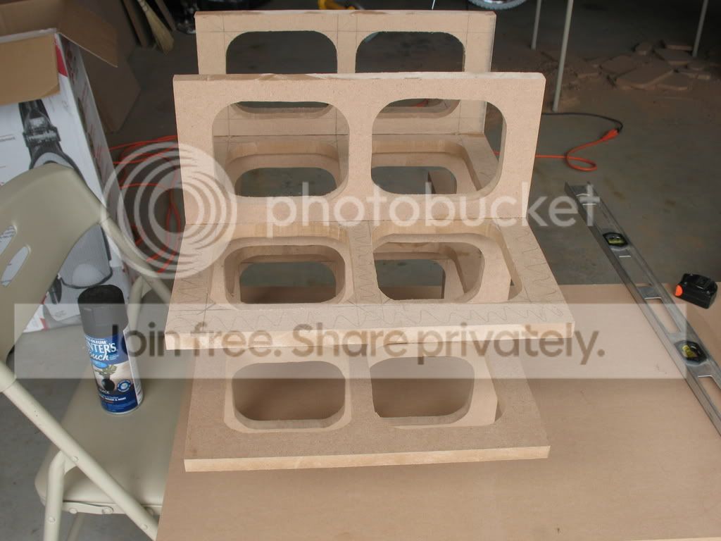

Here are some first stage pics:
Some bracing pieces:
Unassembled port & port braces:
Rough assembly of enclosure held with clamps showing port opening:
Front view of assembled internal bracing:
Rear view of assembled internal bracing:
Top view of assembled internal bracing:

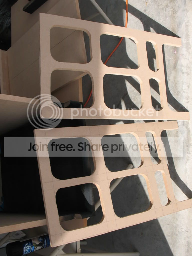

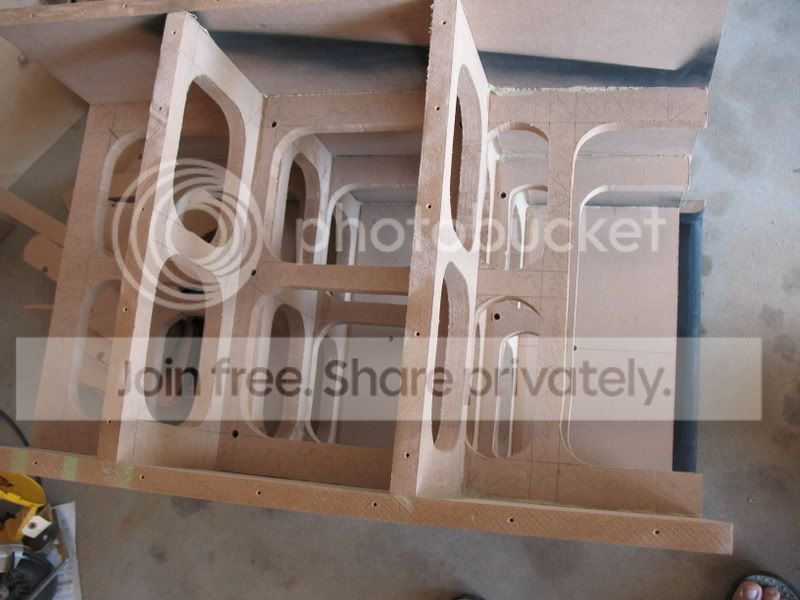

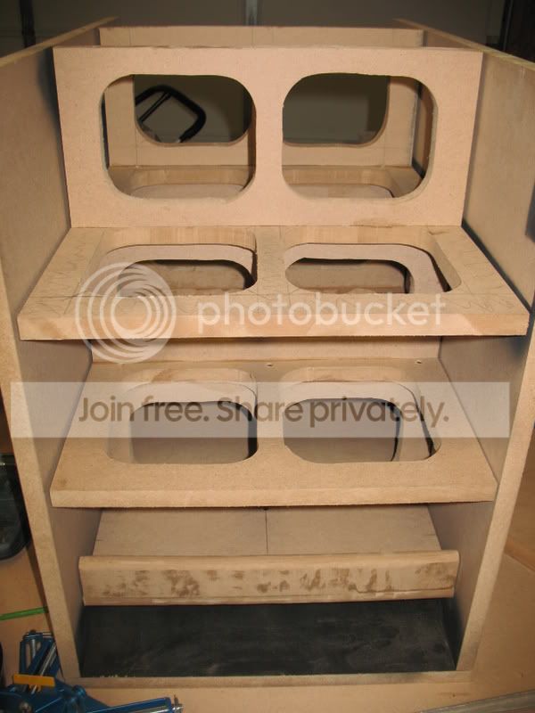

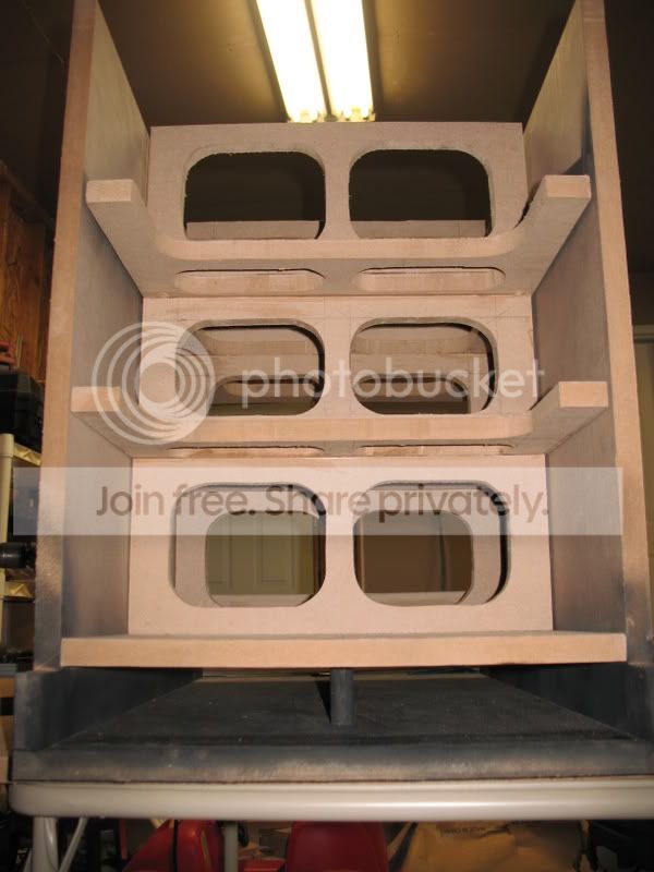

I have a few more updates on the enclosure build.
Bracing with port attached:
Here is a rear view of the bracing roughly fit into the enclosure:
This is a front view of the roughly fit bracing:

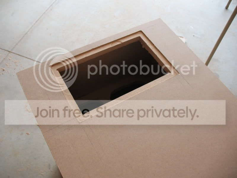

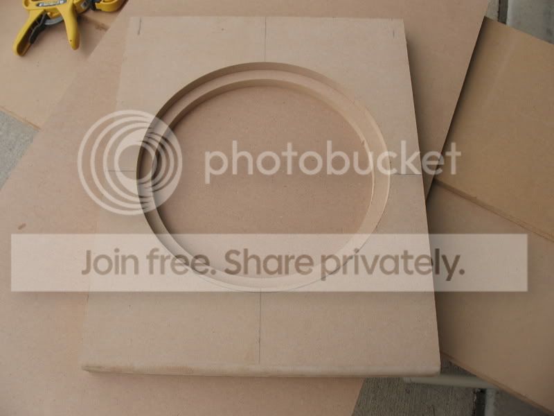

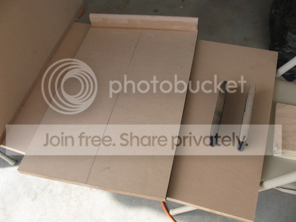

Sorry for not updating this on a more regular basis but finding time to post has been scarce.
Bracing all securely mounted in:
Recess cut for plate amplifier:
Baffle cut outs for flush mount:
