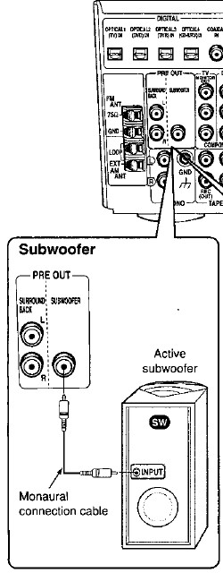

Maester wrote:
My amp doesn't have LFE out
Going off the photos from your Sig link, it looks like you have the Panasonic SA-HE200 receiver, is this correct?
I found the manual for the Panasonic SA-HE200 receiver, and going off page 9 of the manual it does have a LFE/subwoofer pre-amp output(see the attachment)
If you use this output, you can utilize the receivers bass management.
cheers:)

Heh, well here is the noob part of me coming through... I had LFE confused with something else, but yes, MACCA350, that is my amp, and thats how I have it hooked up now, lol. I just made a mistake. *blushes* :eek:
