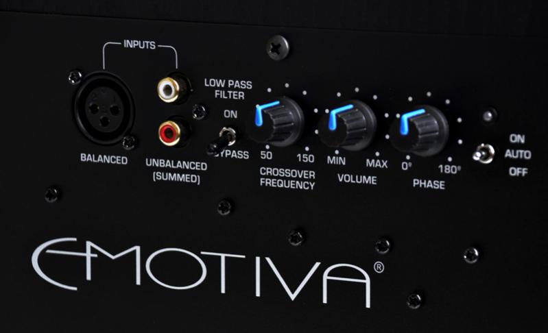

I am sorry but my emotiva subwoofer http://emotiva.com/ultra_sub10.shtm
does not have a single RCA connection like others it has either a single XLR or a two (white and red) RCA inputs.
So I assume I would need a Y spliter connecting my single RCA output from my receiver to the two connections on my subwoofer or the other option is single RCA on my receiver to Single XLR on my subwoofer using the cable like this.

Did the sub come with instructions? What does it say?
Rickster71
Rickster71
From Page 11.
RCA/Unbalanced Inputs Input for an RCA/Unbalanced connections. Connects to your preamplifier or processor subwoofer output with an RCA/Unbalanced cable. Both are mono inputs and can be used singly with a preamplifier/processor that has a single RCA subwoofer output, or can be used together as a summed input with preamplifiers/processors that have dual or left and right subwoofer outputs.
