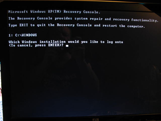

ok. i tried booting from the cd. i got to here,pic. but nothing i typed did anything, except Exit, that put me back at to my problem.
so, what do i type here ?

You type 1 and hit enter. You can then type Help for a list of commands, but the first thing you should probably do is run chkdsk /r and be patient, it will take quite some time.
