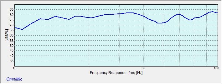

    I'd like to say it was skill in placement, but it's mostly just sheer dumb luck :D
    Here's the response at the listening position, unsmoothed:
    [​IMG]
    Not ruler flat, but pretty darned good for as little correction as is applied I'd say.

  11. KEW Audioholic Spartan
    KEW
    Joined:
    Jul 12, 2009
    Messages:
    5,426
    Likes Received:
    1,942
    Location:
    Jowjah
    Might be interesting to run Audyssey with the microphone in the listening position for all trials and see how that compares.
