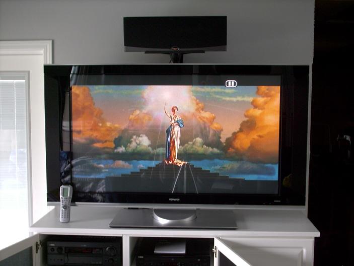

Wana see how the Pro's do it? $2 per click ;)
The speaker pictured here weighs about 36lbs
Hint: what svivels, has adjustable angles,built in cable management, will hold 50 -60 lbs
and comes with a saftey strap? :)
MarkSJohnson
MarkSJohnson
Ok....
I give. What?
Looks like a Bogen contraption...
RLA
RLA
13" TV mount available at any Home Depot the mount comes in
Powder black finish and has a very small mounting plate if installed correctly
It looks as though it was designed for a center channel application
The ones with the short extension arms and square tube frame look the best
This will satisfy even the pickiest significant other if installed correctly
and it places the center channel above the monitor at the correct angle
You Owe Me $2 :)
You Owe Me $2 :)
Excellent idea!....My $2 check will be in the mail :)

THX that set up looks good but the Center speaker is supposed to be equal with the picture screen that looks set back?
RLA
RLA
Nope its perfectly aligned But even if it was set back I guarantee there would be no
Person alive that could detect an audible difference ;)
