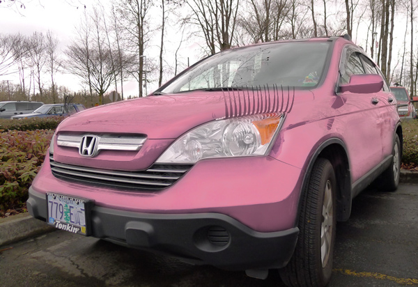

Hey, how did you get a picture of my car? Did Adam share his cam url with you?
Sorry, my bad. I was monitoring my cameras as I took the mask off when I thought he said the safe word. Turns out, "door" isn't the smartest safe word if someone is mumbling through leather.
