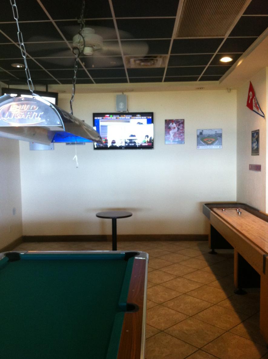

Hi guys,
I was wondering what would be the best projector for my sports bar? It's rather well lit and I was wondering if this is even a viable option.
Here is the space I'm looking at, and I was thinking of a screen size of 120". For reference the TV that is on the wall now is a 51" LCD.
Sorry for the crappy cell phone pic.

Thanks for the reply. This is for my business. Like I said my ability to control ambient light is, lets say, less than desirable. I own a sports bar right on the beach on the Gulf of Mexico so for about a half an hour everyday I have direct sunlight streaming through the windows. This doesn't concern me too much because, like I said, it's only a half hour, but there is a good amount of light in the bar during the day.
What type of screen should I look for to cut down on some of the ambient light issues?

Thanks again for all the suggestions. I essentially have an installer on retainer, we just upgraded almost all of our TV's in the bar. Right now we have about 40 LCD's and plasmas ranging in size from 32" to 65". The area you see in the photo is really the only wall where putting a screen this big is even feasible. What you don't see is that there is a bar that seats about 50 people and a seating area of another 40 or so that all have a relatively clear view of that wall.
I figured that the screen would be pricey because of the light issue and I'm fine with that. As far as price goes I'm not set hard and firm on that $5000.00 number, it's just kind of the ballpark I want to be in. I was just trying to stay out of the $150,000.00 media wall ballpark:)rolleyes::eek::D) and still have a "WOW" factor.
