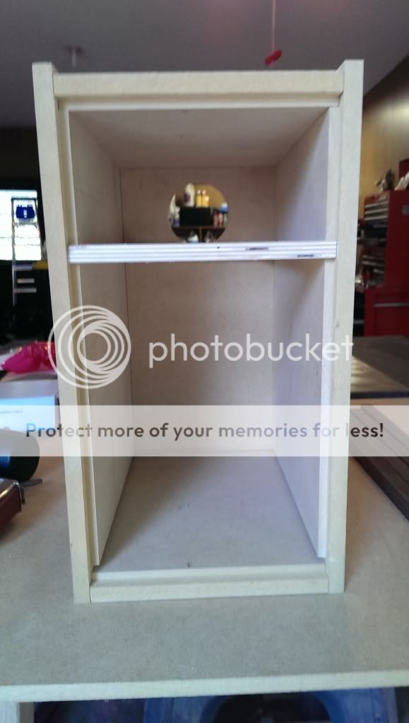

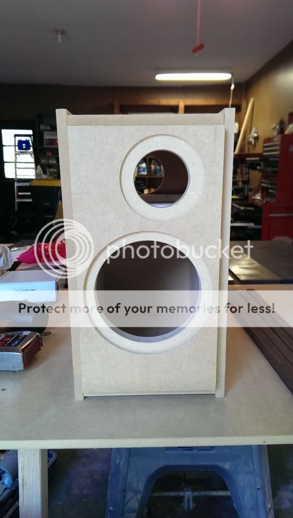

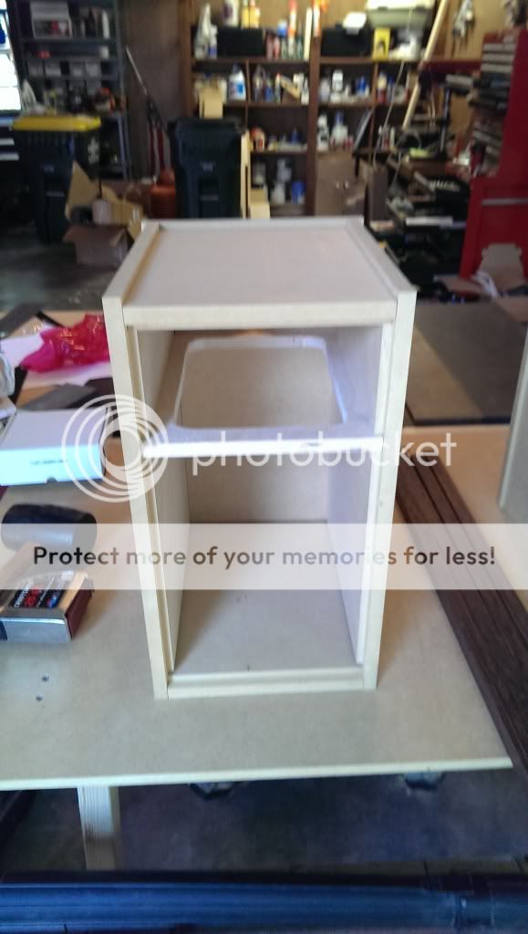

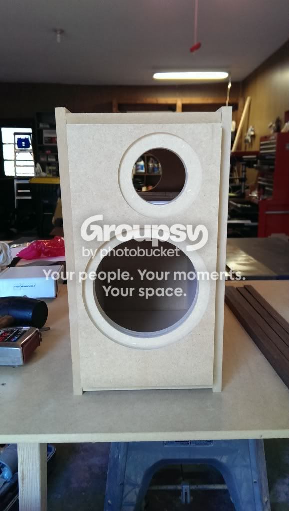

So of course I need to replace the EMPs and fuzz inspired me to try out the Mandolins since his turned out so nice and he appears to really like them.

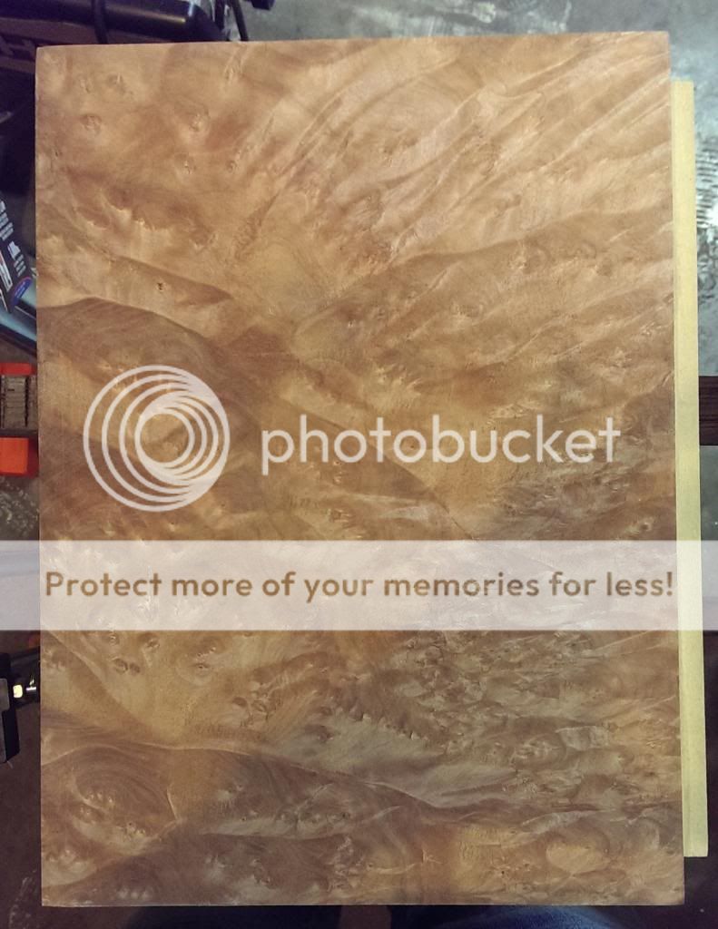

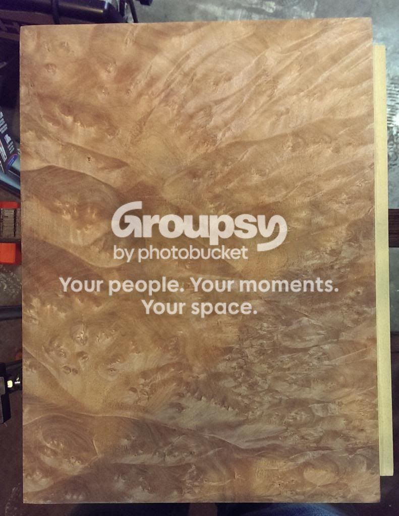

I plan on finishing these with the Pelin Burl veneer above with the Wenge trim around the front that I'll round over. My test piece of using the iron-on technique turned out okay, but I got a couple of cracks. I think I used too much glue as it took twice as long to dry as it should have and this caused the veneer to really curl up almost into a bowl shape even though I had it taped down. I ignorantly tried pushing the edges down thinking it would give without harm, but I was wrong. I'll do another test piece with some veneer softener and less glue before I try applying it to the speaker. I'm still at the dry fit stage as I haven't actually glued anything yet, so the veneering stage is down the road.

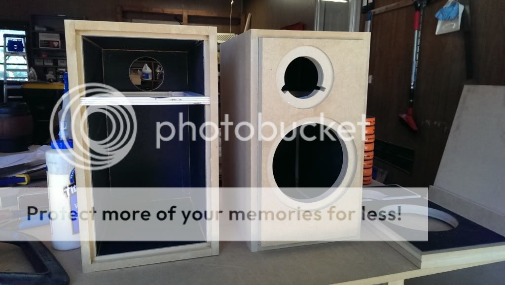

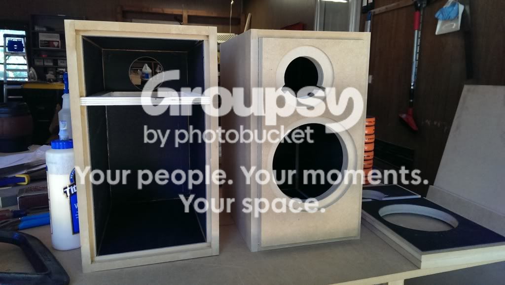

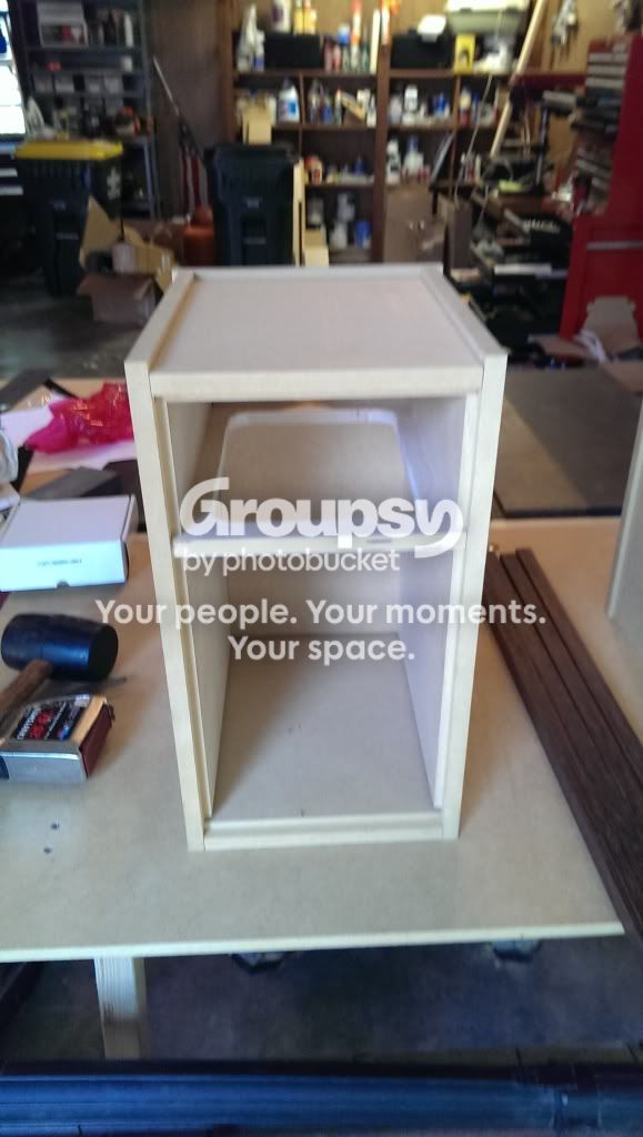

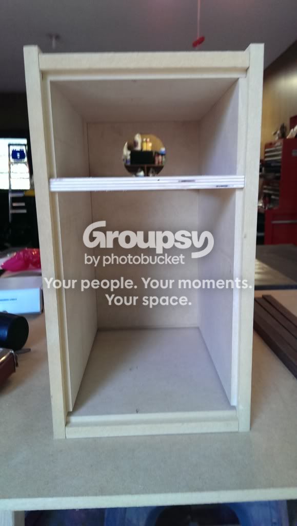

Well I have everything glued except the front baffle. I got all the wires to the crossovers soldered and all the flush trimming done around the edges of the cabinet. I added some Sonic Barrier Lightweight Vinyl Damping material to the interior of the cabinet as well as you can see from the picture.
I also got a chance to practice my veneering again and this time it turned out much better. The veneer softener really helped as I had no cracking around the edges. However, there were some minor cracking that occurred at the same exact spot as the first piece which is through a fairly big knot in the burl. It must have happened when I left the veneer to setup after ironing, because I thoroughly inspected it after ironing and didn't notice anything. If this happens when I veneer the cabinet I don't see a huge problem in filling these cracks as they're fairly minor. I will also try spritzing the veneer with softener after I iron it to see if that helps.

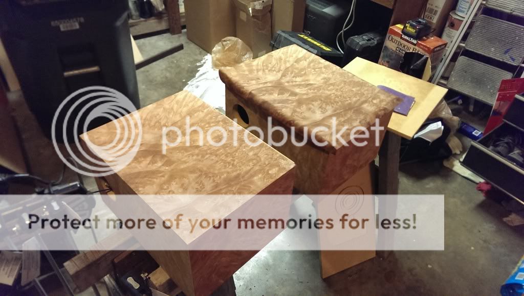

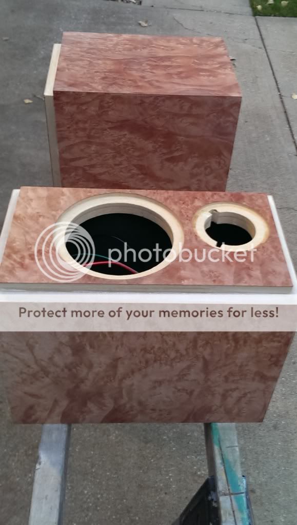

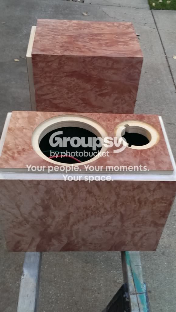

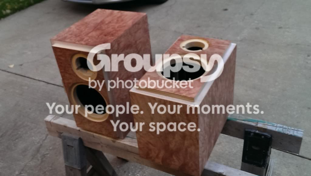

I thought I'd share some new pictures of the veneering process. Edges sealed and bondo applied (man does that stuff set-up quickly) and sanded. So the veneering process goes like this for the Pelin Burl: Spray the veneer with veneer softener, iron the veneer to dry it out which leeches out a lot of the color, cut to size with a box cutter, tape the veneer down and apply veneer glue to the veneer and the side of the speaker I'm veneering, wait impatiently for 30-60 minutes for the glue to dry, carefully line up the veneer because once the glued surfaces touch each other it doesn't like to be adjusted, and iron with a tee shirt as a buffer, re-spray with veneer softener.
With the wild grain pattern I've been getting ridges that will not lay down no matter how long I iron, so I've been ironing and then pressing down with a spare piece of mdf and then clamping down a platen board for 30-60 minutes. This seems to work pretty well. I check it after about 30 minutes and if they are any bumps I re-iron and clamp again. It takes at least an hour per side, so this is a slow going process. Anyway on to the pics:
I still have the top and fronts to veneer. I'm waiting for a router bit to flush trim the speaker flange cutouts before I'll be able to finish the fronts. I also got some bright red, bordeaux, and red mahogany dyes that I'll try out on some spare pieces to see if I go that route. I'm also rethinking the wenge trim and may just go with a dyed maple...we'll see.

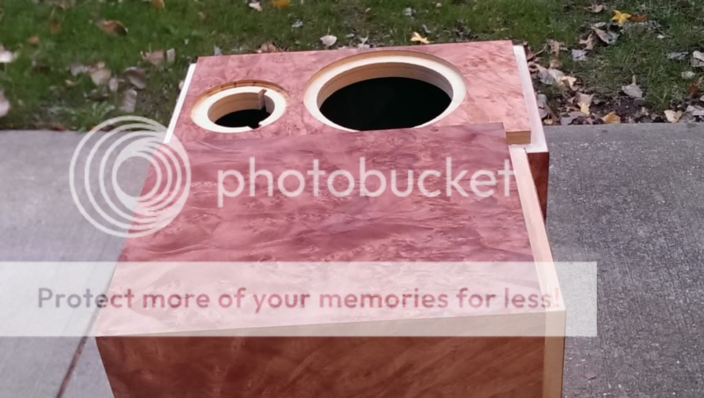

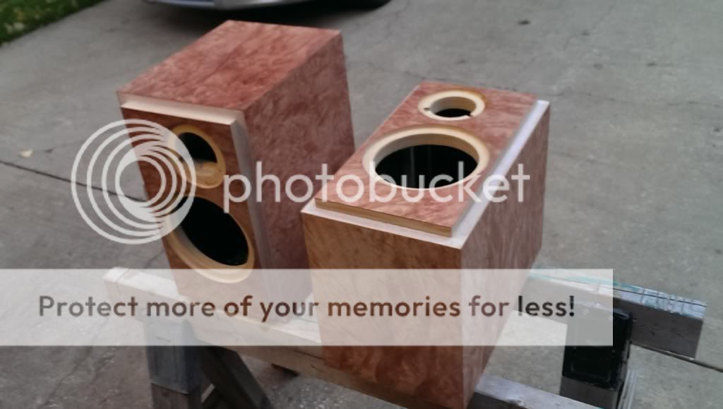

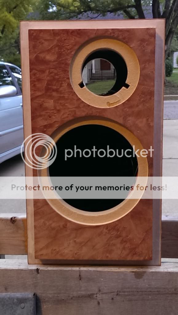

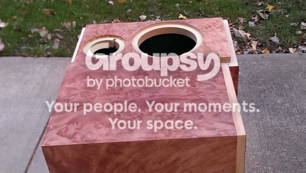

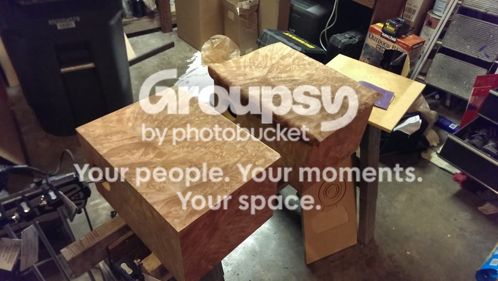

Fully veneered now. Sanding, filling imperfections, dyeing, Waterlox application and figuring out what trim I'll go with remain. In other words, lots to be done...
Got a little overzealous with the depth on the bit I used to trim the flange cutouts for the tweeter as you can see from some of the pictures. Shouldn't be too hard to fix that.

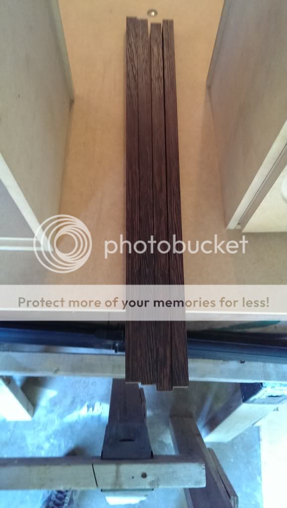

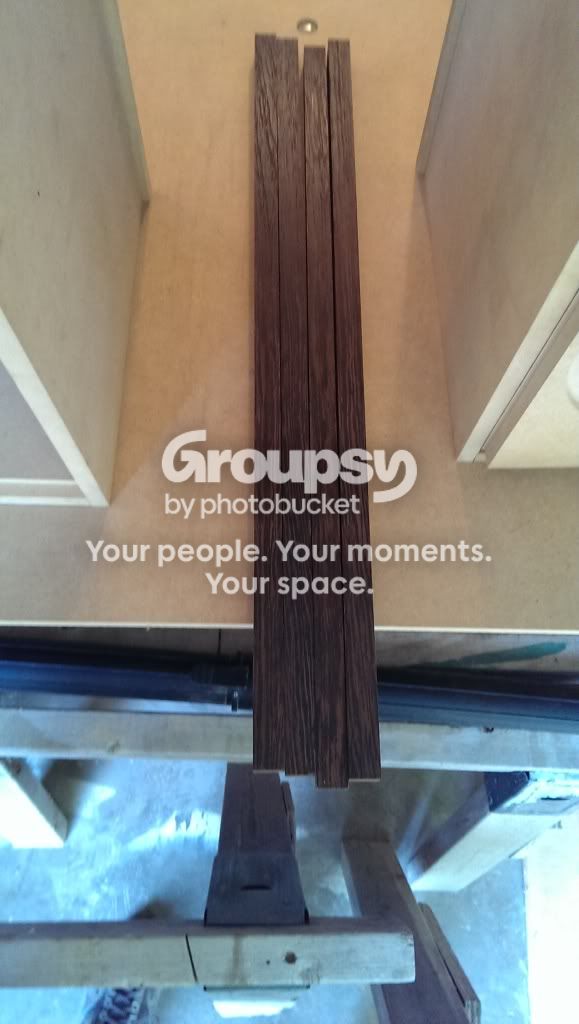

Thanks fuzz. I have looked far and wide and have considered everything you thoughtfully mentioned above. I even took my burl into Woodcraft and held it up against everything they had and that's why I got the wenge as it provided the contrast I was looking for in the store, but now that I have it at home and cut into strips and placed it into the cutouts, I'm not too fond of it. I would really like to use ebony, but I can't find a piece that I can cut down at a reasonable price, plus it is harder and tougher to work with than the wenge and my table saw didn't like that stuff too much.
I plan on dyeing these with either the bright red, bordeaux, or the red mahogany Transtint dyes I bought if I like the way they look after testing. I got the inspiration from the bright red pelin burl on a set of Cirrus Blacks from Vapor Sound:
I'm gonna wait until I have the rest of the speaker finished before I decide on the trim as the dye and Waterlox will change the way they look. If mine turn out even remotely close to the beauties above I'll be elated.
