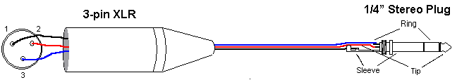

Just so we're clear. I am not using XLR inputs/outputs anywhere in my system, only balanced TRS. There is no XLR connection involved with my interconnects. Thus your diagram showing a balanced XLR connector at one end and a TRS at the other should instead show a balanced TRS jack, not an XLR. Correlating the XLR to TRS is easy but gets confusing since the TRS doesn't go by pins 1, 2, and 3.

It makes no difference whether you have xlr of TRS, but you have to reference TRS to xlr, to understand the lead number one two and three.
You must never leave a pin unconnected as you only have half the wave!
I have absolutely told you the correct way to go from balanced to unbalanced.
The negative deflection must be connected to ground. If you connected tip or pin 2 to ground you would have an out of phase condition.
I do think you understand it now though.
