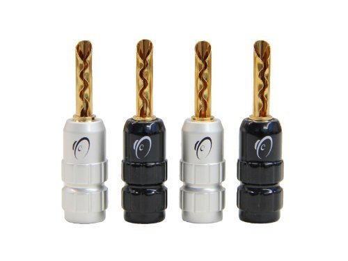

I like these better than the sewells personally:
http://www.amazon.com/Nakamichi-Speaker-banana-Audio-connector/dp/B00G7QDVRU
I bought them direct from Nakamichi and they were actually almost half that price. http://www.nakamichiplug.com/
