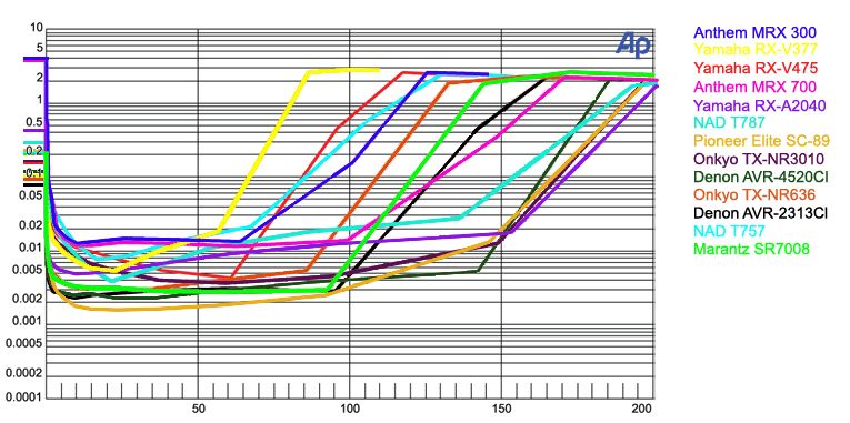

I wanted to see how they compare directly so I made a combined chart out of those, don't know if there was kind of chart already available. But anyway here it is, not perfect but it did the job for me!
PENG
That's pretty good, though like you said it wasn't perfect but good for a quick snapshot comparison. You may be able to make it perfect if you first make the aspect ratio and size exactly the same. I am not asking you to even try because I know it will be very time consuming, not worth it at all.

Actually I did some adjustments with image size/locationing to match both wattage and percentage lines so it should be pretty close but there is room for errors as I didn't want to use too much time on it.
