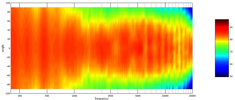

There was a good
AudioHolics article by Gene that addressed this question of just how good or bad is a sideways MTM speaker used in the center? His answer was they aren't that bad as people say. It does depend on how wide a rooms seating arrangement is, and how far away the seating is. Most rooms aren't wide enough for the problem to become big. Sideways MTM speakers as center channels, in my opinion, get a bum rap.
