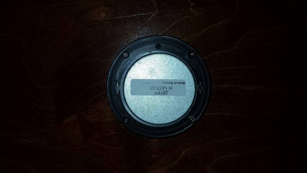

Here are pics of one of my Sierra1 tweeters
29TFF
H 1477-06
Made in Norway
1507.../f

That actual tweeter is NLA. It comes from a time when 8 and 4 ohm versions were available. Manufacturers now find it easier to just make one 6 ohm version. That tweeter is the same as yours except with a 6 ohm voice coil.
So you have two options. See if Ascend have any of those old tweeters left. The other and probably better option is to look at the crossover and look at the component values of the high pass filter and the L-pad. I can easily recalculate the values and you can change the components and install the new tweeter. It is certainly possible we will only have to change the L-pad.
The latter is the better option as the old tweeter may have failed because the ferro fluid has dried up. If that is the case, then you don't want to buy an old one.
Since your current tweeter is no good you should remove the dome and VC and see if the ferro fluid has gone hard. If it has do not buy old stock.

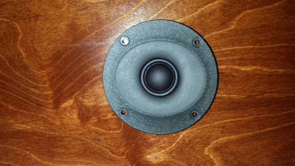

Here's my tweeter
https://imgur.com/a/k1vRo
It says 6 ohm right on it unlike the one above. The one on Madisound indicates it's a 6 ohm nominal. Seems more likely that the tweeter is the same.

I wonder if that's the -06 after 1477 in mine? Mine am not sure of original sell date, as I bought used 6-7 years ago or so and can't find the paperwork the previous owner gave me; I have s/n's 95000161/2 (and the center is 170 :) ). No indication of impedance marked elsewhere either, just checked.
It is. Just buy one and stop pissing about!
