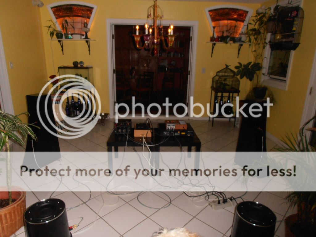

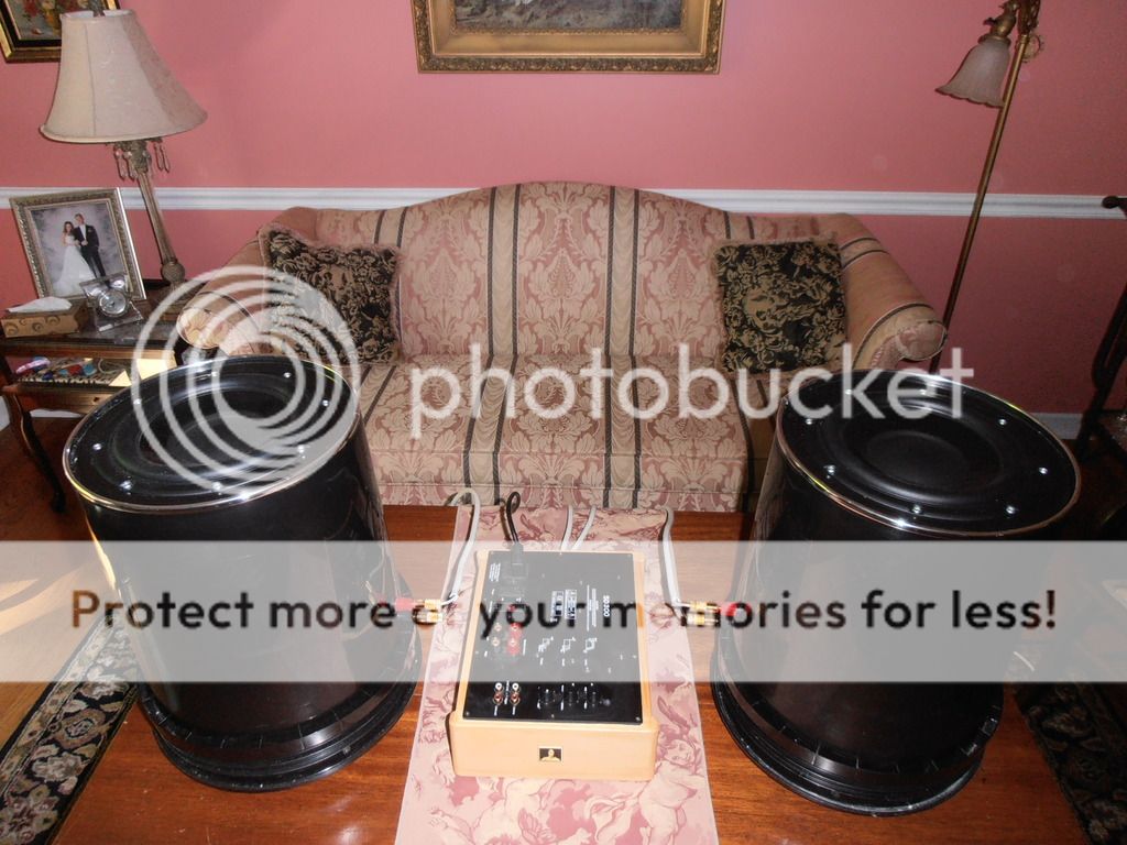

These bucket subs can be put together with no special tools. They're 5 gallon buckets turned upside down with a few inches of concrete in the bottom. The Peerless 10 inch woofers cost $66 each at Parts Express and the 300 watt Yung plate amp goes for a little over $100. Great detailed bass that integrates so easily you don't realize they're playing until you turn them off. Then you realize how thin your speakers sound without them.
Imagine what you could do with a couple of 55 gallon drums with 18's.
