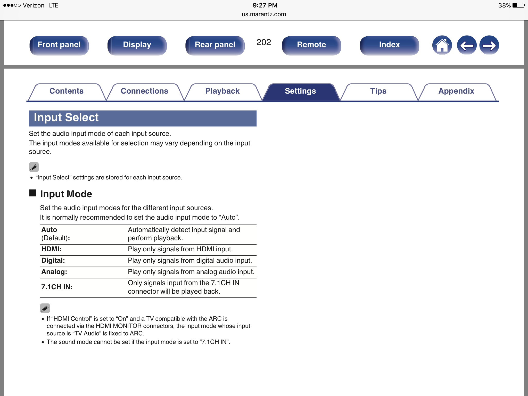

Ok..assume you mean this section (see pic) in the input mode on the AVR... It is likely set to "auto" for all the hdmi inputs. perhaps I will manually change the input mode and see if that helps (assuming when I try the new amp..I experience the same issue).
