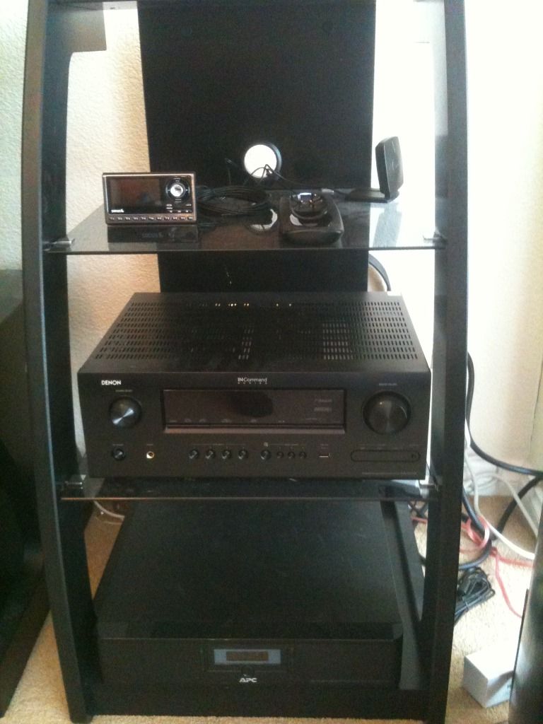

This is my current set up. I know I need to add a sub sometime soon, leaning towards SVS for that. I know polks aren't the most popular around here but I'm really happy with them :) Pics taken with iphone, sorry :)
Speakers
Towers- Polk Rti a7
Center- Polk Csi a6 (I've got it flipped upside down so the speakers are actually facing slightly upward)
Rears- Polk Rti a1
Electronics
Sharp LC-60e78un
Denon avr-3312 ci
Sony BDP-S360
Logitech Harmony one
APC j35b
Sirius satellite radio dock
Optik tv pvr
xbox 360 with kinect

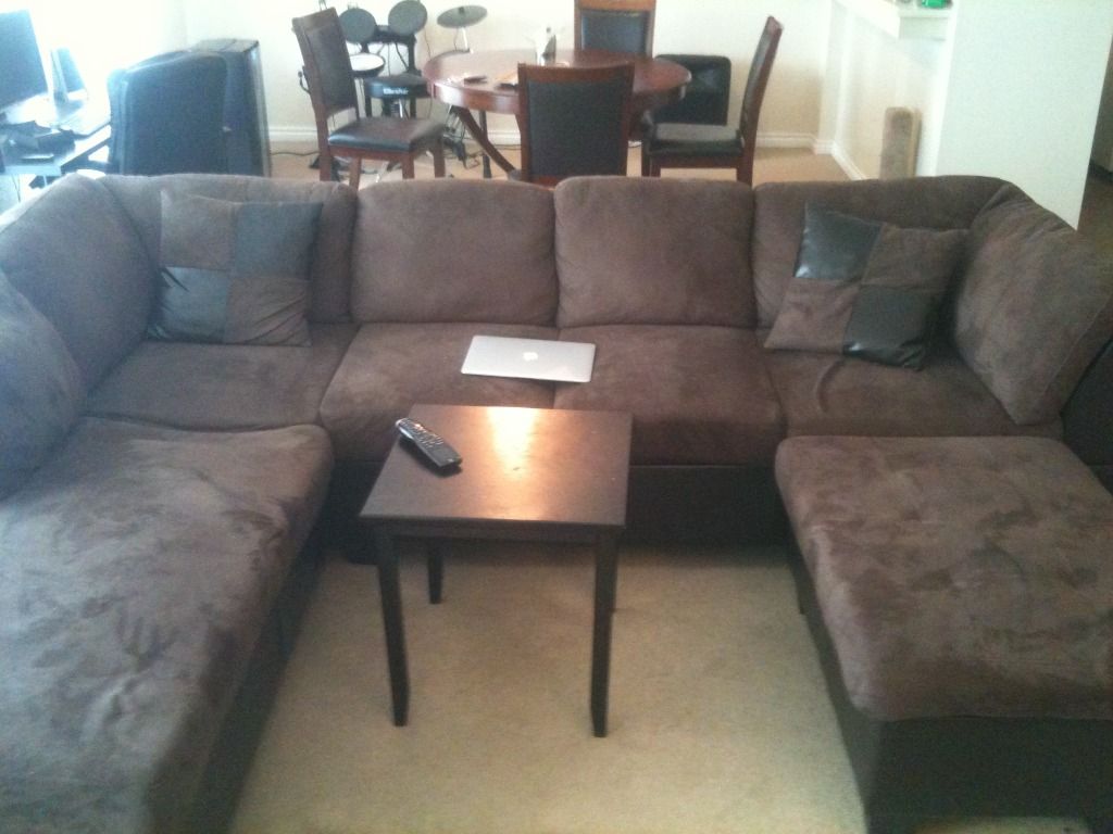

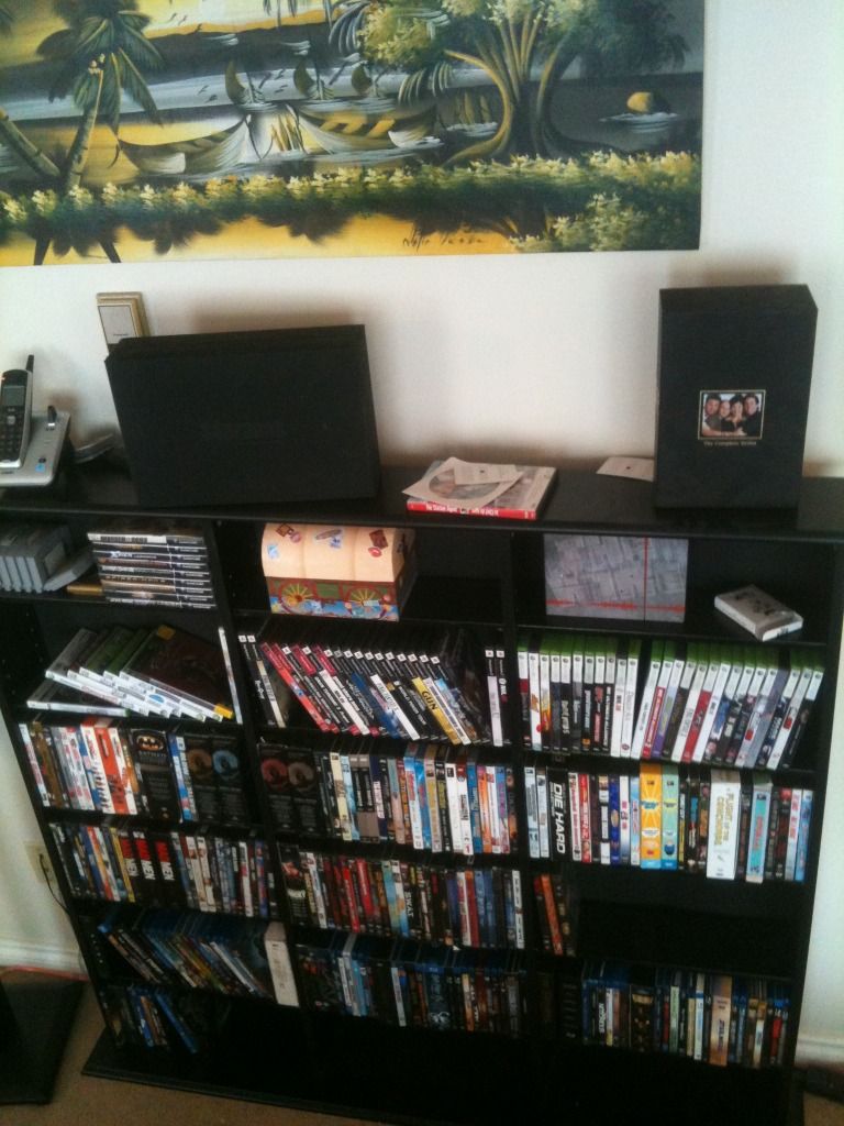

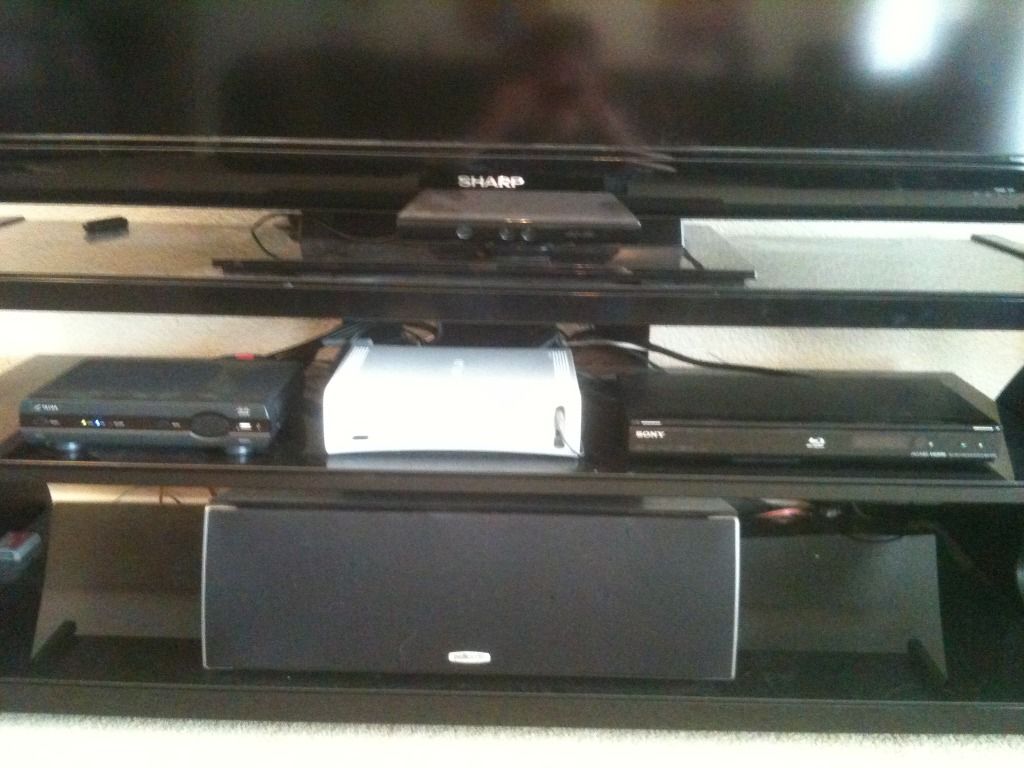

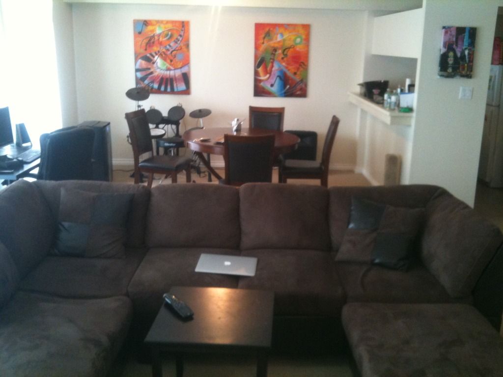

Well, I've got the great gramma in and waiting now, and I decided to attempt some nicer pictures to give you guys a better sence of the space. Hope you like them :)
Blu Ray/DVD/video game collection
View from the tv
better picture of the couch
(slightly) better picture of the tv stand
(slightly) better picture of the component stand

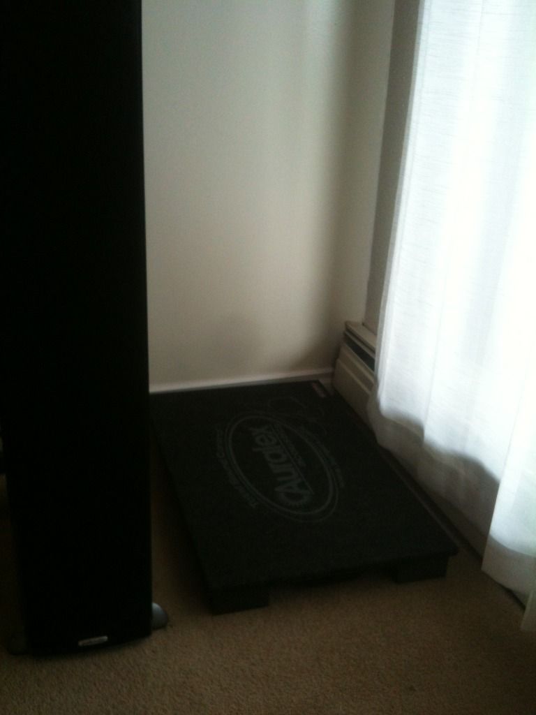

and the Great Gramma in one of it's possible locations (pending bass crawl)

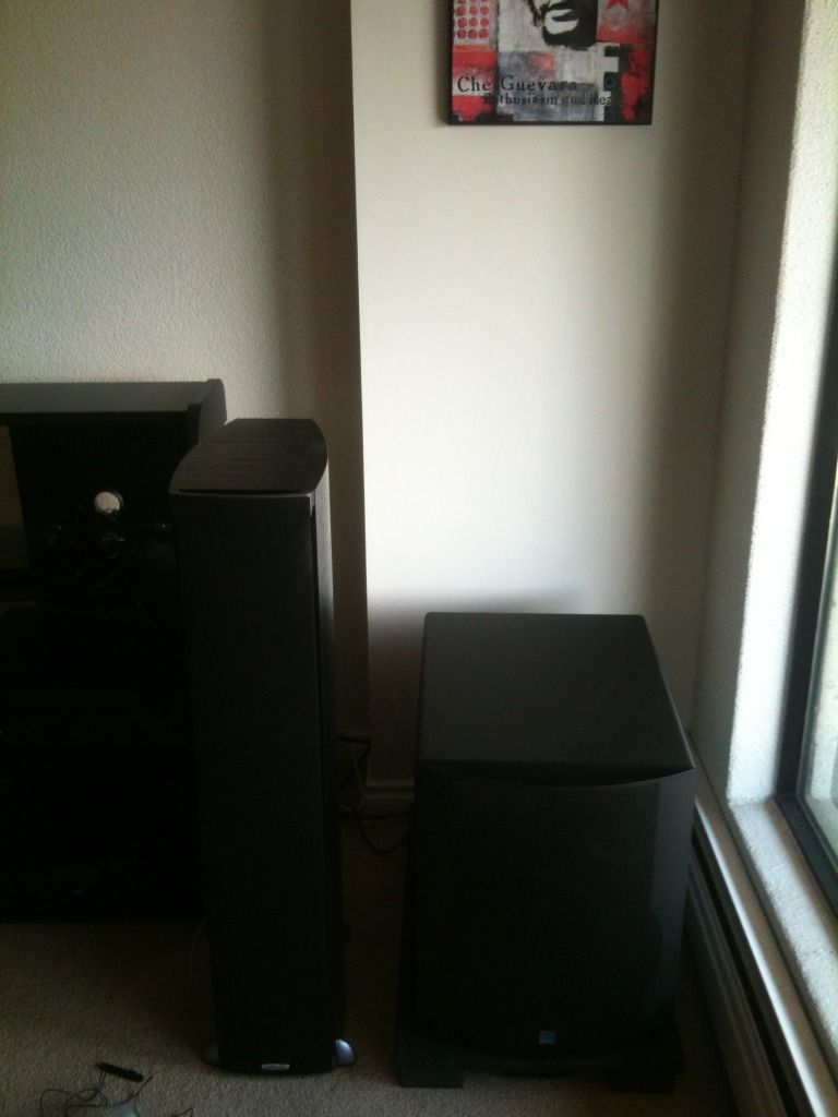

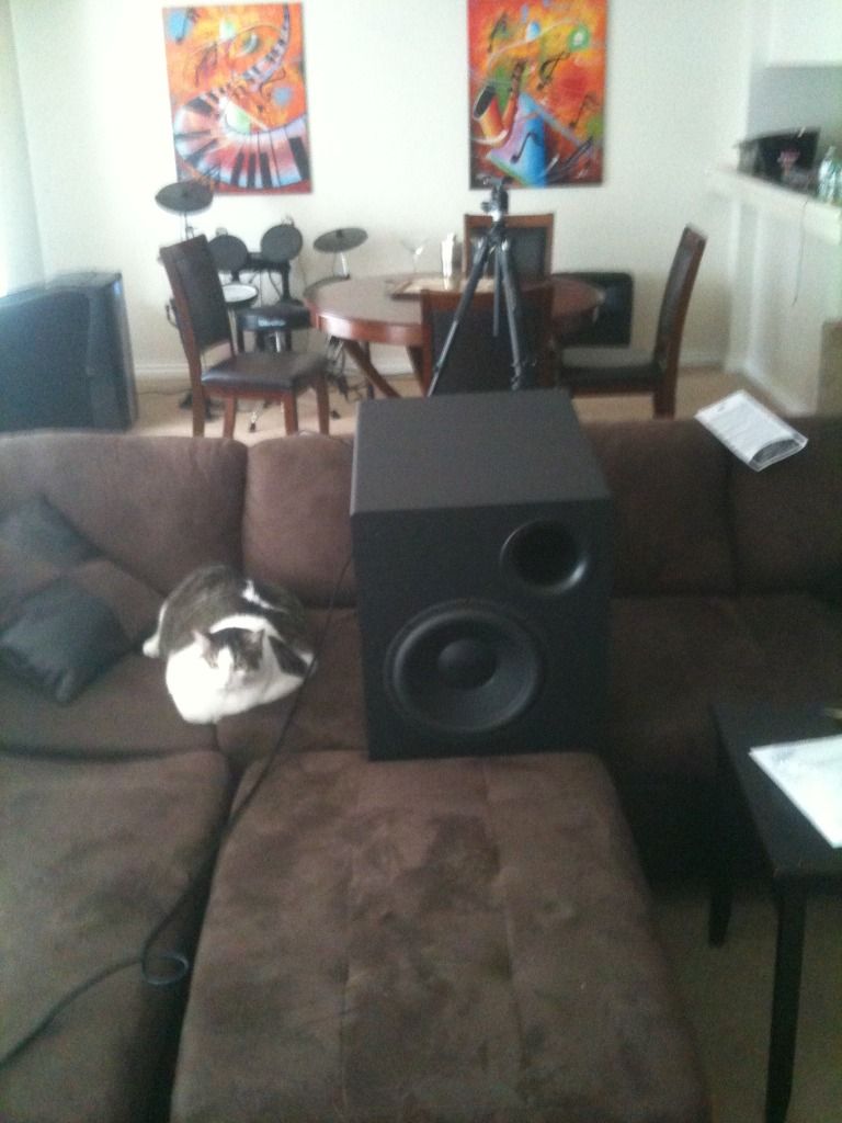

Placing the sub for the bass crawl
Final placement of sub
tripod (the benefits of knowing a photographer in the building) for calibration

Hey CONGRADULATIONS buddy I'm glad to see you got yourself a nice sub. New subs never sound their best new. They take a solid 30-50hrs to break in so give it some time then recalibrate!!!! It'll get deeper & louder trust me!!!
