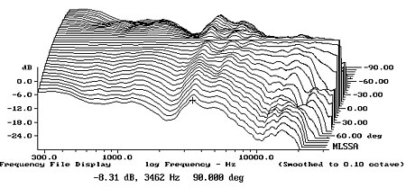

Another example of the same design you have been criticizing...
Fig.6 PSB Image T6, lateral response family at 50", normalized to response on midrange axis, from back to front: differences in response 90–5° off axis, reference response, differences in response 5–90° off axis

The crossover is just north of 2kHz, right? I can tell by the excess of energy in the on-axis curves there.
Criticizing with good reason. Look at the mushroom cloud of midrange energy centered around 2kHz.
I didn't know PSB know how to make crappy sounding speakers, learn something new every day..:D:D:rolleyes:
I wouldn't use those speakers without fairly significant sidewall treatments. Which, since I prefer not to live in a padded cell (yes, I'm stealing AJ's words, but they're perfect), is to say that I wouldn't use them.
Same midrange bloom I see in the Kefs. It's clear to me from your miss reading the graphs that your personal biases shine through and you mistake them as facts. I have clearly shown the decrease in midrange energy with my graphs but you choose to ignore the facts. Maybe you are better off in a padded cell then spreading your audio tripe and BS that you so liberally fling at people here on this site.
