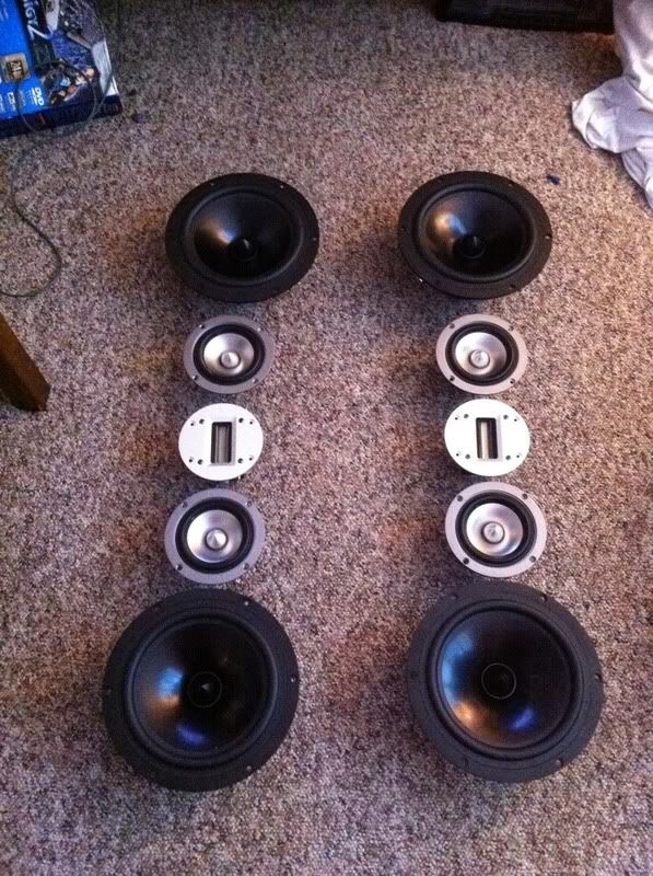

"It's beginning to look a lot like Christmas..."
All of my drivers are in!
All of the crossover's shunt parts have arrived, as well as the two smaller inductors. I'm waiting on all of the in-line components to arrive, along with the woofer inductor. Then I'll snag some wood from 84 Lumber and make this deal happen.
You have to have a buwhahaha moment when you get those puppies in and line them up. You know something special is coming.
Still on the fence about whether I should have done the silver faced ribbon tweets or not...
Oh you know I had one, haha. I was a little on the fence once I pulled them out of the packaging. They don't exactly match the mid drivers. They're a little brighter or lighter or whatever you wanna call it, but it's growing on me fast. I bet you could order a new front plate to put on and see what you think.

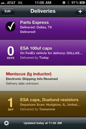

It's gonna be an exciting couple of days... :D
Not to mention I have a new laptop coming soon too

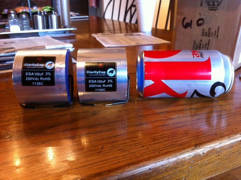

The mail came :D
And yeah, they're really bigger than a Coke can

WOW those are big :eek:
Maybe I missed it, but what finish are you doing?
It's crazy to believe, but there's still the ESA 600v and MR lines that top this one. They're even bigger. Not by much, but still.
