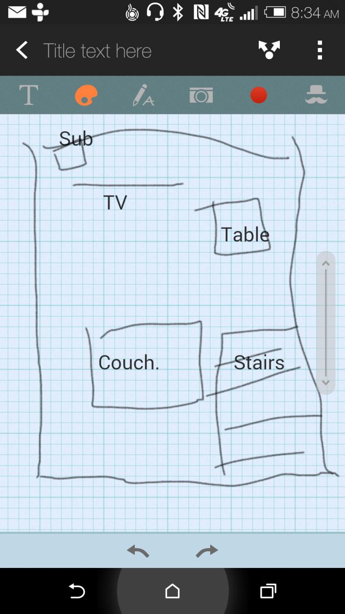

I'm currently using a Klipsch Synergy 12. Good enough for movies, but craps for music. Also, a fair amount of deadspots in the room. Room is 22x15w. 75% of the right side of the room opens up to dining area or upstair-case. Listening position in about 12-14ft from speakers.

Being more impressed with quality sound in music, should I go sealed? Will 1 of these subs fill my space just fine with a pair of Sierra 1's?
I would Brian, because I'm partial to sealed subs in general. But an accurate sub is an accurate sub regardless of whether it's ported or sealed. A ported sub will have greater output at port tune, which is handy to reproduce the loud/dynamic LFE (boom!) in movies but response drops off quickly (24dB/octave) below tune. The equivalent sealed sub won't play as loud but it's gentler roll-off (12dB/octave) gives it an opportunity to lock into some "cabin gain" from the room and extend it's low end. For a ported sub to play as low, the box needs to be significantly larger to lower it's tuning frequency.
I personally favour sealed subs for this smooth and extended in-room low end and their relatively compact size. The compact size also makes it easier to scatter more around the room to achieve a smoother response over the listening area, further extend the low end and increase the total output by an average of 3dB each time you double the number of them.
My favourite sealed sub is the Rythmik Audio • 15" servo subwoofer F15. As you may be aware, you can order Rythmik via Ascend Acoustics. As you're a very recent Sierra customer, Ascend may still give you the "5% when purchased with speakers" discount.
With respect to filling your space (2640ft^3 assuming 8' ceilings), I have an email at home from Enrico at Rythmik advising what space a single F15 can "handle". I'll find it later and let you know.

Reference the above, below is the advice from Rythmik I received. To explain, Rythmik's DS1501 CI kit builds a DIY F15 and the DS1510 CI kit builds a DIY F15HP or FV15HP.
Two DS1501 CI Kits can handle easily a room till 6000 cuft, so you should be fine. As you said, two DS1510 CI Kits are overkill.
Best Regards,
Enrico Castagnetti
Rythmik Audio - Tech Support
You can readily infer from this that a single Rythmik F15 will fine filling your ~2640ft^3 room. :)
