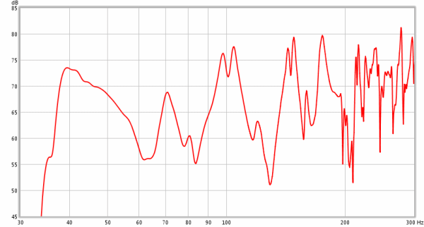

Dennis re-posts the on-axis measurement and it looks like this:
I've checked and rechecked my measurements, and I swear there is no dip at 62 Hz. It appears that I've completely bought out all of the Pioneers from my supply source, along with the tweeters. They hope to get them back in by Monday, and then I can fill more orders. I'm selling lots more of these $150 speakers than my $3500 jobs. Go figure.
