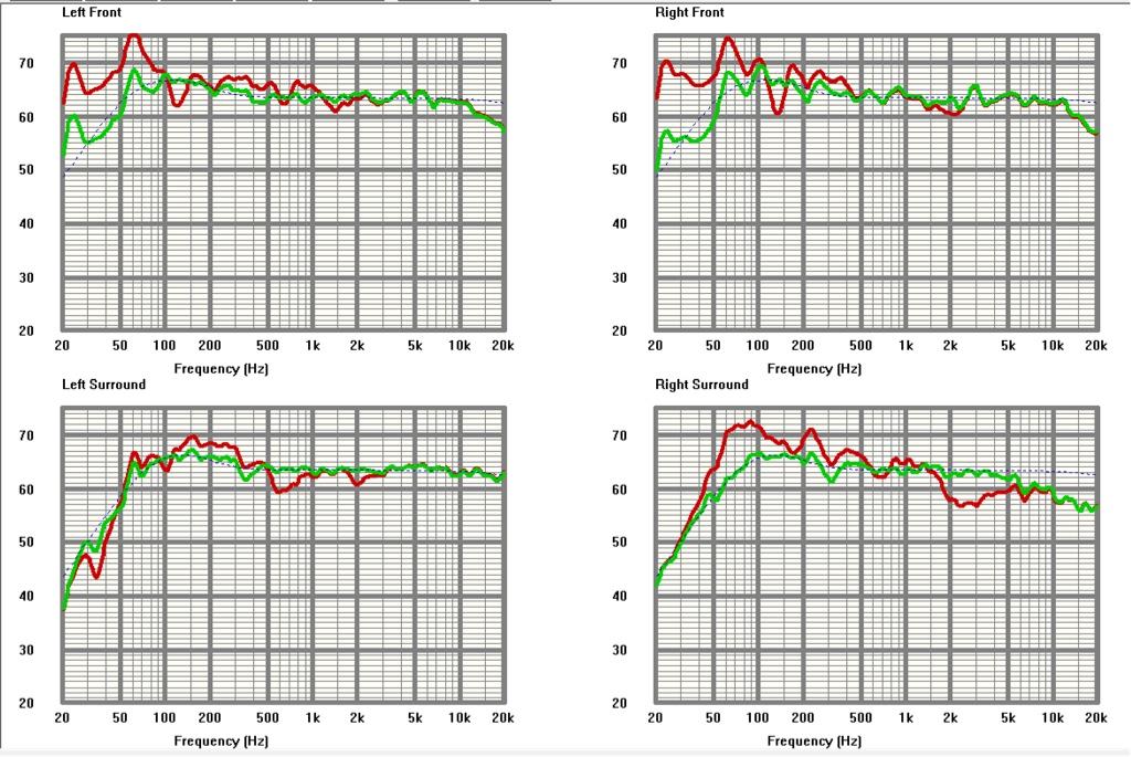

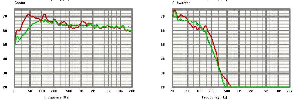

First of all, ARC Genesis is quite good, especially now they have fixed the issue with deep bass, via the recent FW update. I won't use my graphs but another member who experience similar issue with his MRX 740, the one you seem interested in getting.
ARC Genesis results | Page 9 | Audio Science Review (ASR) Forum
You can see his REW FR graphs, comparing before and after the update. Obviously the difference is not all because of the updated FW, as every time you run ARC G you will likely get different results, though the big difference in the deep bass range is most likely due to the bug fix.
He posted the above on Dec 20 2023, the one below was from June that would be with the FW before the latest update.

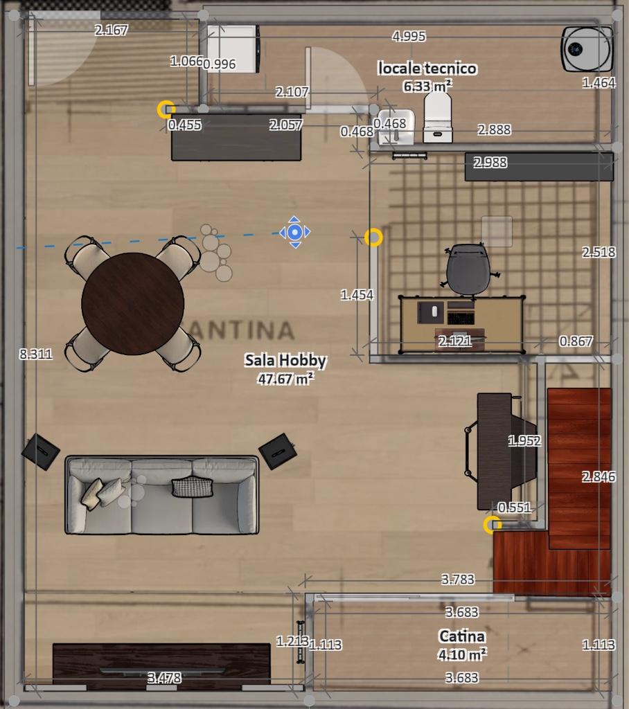

Unfortunately, the placement of my speakers is quite constrained due to the room's layout, leaving me with less-than-ideal positions that negatively impact the low frequencies. Both of my front towers are cornered, with one next to a large column radiator, and the subs are also in corners, leading to significant bass resonance. The room's challenges, like a staircase on the left of the listening spot, an open fireplace, an open study room for extra reverberation, and a low ceiling of 2.45m, further complicate the situation.
Given these constraints, I rely heavily on active acoustic correction. Without it, the sound is overwhelming, with furniture vibrating. The current ARC correction makes it better, but I'm missing the punch that my setup should deliver, with the LFE channel only coming alive at reference volumes.

Anthem, like other room correction systems, only show you as you said the frequency response based on their calculations. In my (and many others) experience, you need to use software such as REW and a mic such as the popular Umik-1 to find out what actually is happening. From what you are saying, it is quite likely that Anthem is not doing a good job on the deep bass area, that is below around 80 Hz, let alone a tilted response that most people seem to preferred.
The AVM60 is really dated, and have surprisingly mediocre measured performance, even worse than that Denon AVRs could deliver. Just read and compared the bench test results on ASR and you can see it for yourself. If you can get one at very good price, then I guess you can try one out, as long as it is returnable though.
If you believe your room acoustic is challenging, then I think the AVR (or AVC if you are in Europe) X4800H, or Marantz Cinema 40 will give you the upper hand as you then have to choice to purchase the excellent MultEQ X, or DLBC. Gene used to not impressed by Audyssey, but he, and even Matthew now both seem to like Audyssey a lot, when used with Mult EQ X.
Audyssey MultEQ-X Pro Calibration Results for Marantz AV 10 Processor (youtube.com)
I use ARC Genesis too, if you know how to tweak and have time to do it, you can get very good results too, but I do find Audyssey with the app and DLBC much more efficient and effective, especially DLBC.
