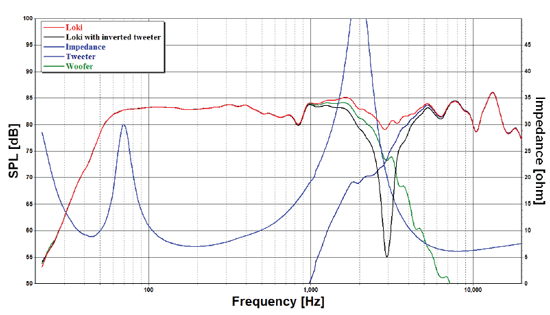

Here is the impedance curve of an 8 ohm speaker.
The blue line is the impedance. The first hump is the impedance rise from the tuning of the ported cabinet. Then the woofer's impedance rises with frequency and then drops as the tweeter takes over.
If you measure this speaker with your fluke meter it will read 6.2 ohms which is the DC resistance of the woofer voice coil. You will not measure the DC resistance of the tweeter as there is always at least one cap in series with the tweeter. Caps do not pass DC current, so your meter will not see the tweeter at all.
Bottom line is that you need to review the physics of impedance and AC circuits as well as at least the elements of crossover topology before making anymore posts like this.
