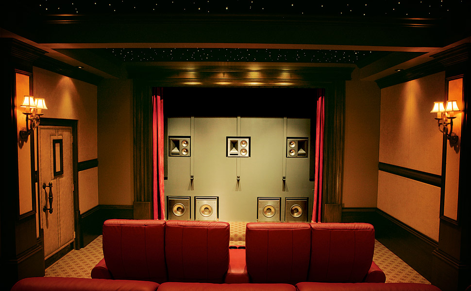

    Another vote for the Klipsch THX Ultra 2 system. I have the RF-7 II Reference 7.1 setup and its amazing, I've heard that the THX Ultra 2 system is even better.
    THX Ultra - THX Ultra 2 | Klipsch
    [​IMG]
    [​IMG]
