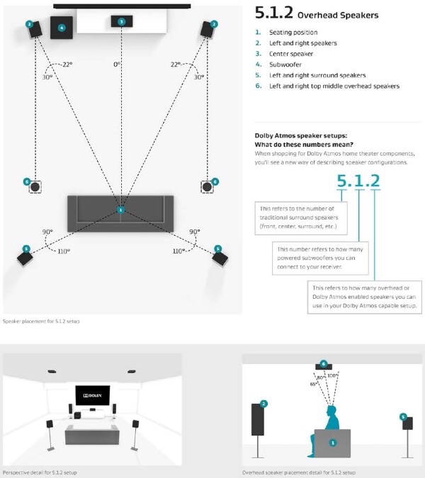

I'm thinking of trying Dolby Atmos out, I've got two options but I'm not entirely sure which is the best option. If it helps my current house has fairly tall ceilings.
In ceiling speakers aren't an option for me unfortunately.
Option 1: Go with Elac Debut A4 and place them on top of my Tannoy Floorstanders. (Easy option)
Option 2: Go with the Tannoy Mercury VRI (I can get a pair for £99) and mount them on the wall just above/ever so slightly behind the MLP firing down.
Option 2 is actually £120 cheaper for me.
I've taken a photo of where I'd mount the speakers if I go with that option.
Would greatly appreciate some advice on this.

I would see if your Atmos processor supports front wides instead of height speakers and just go with front wides instead. Otherwise go with option 2.

The photo is the area where I was thinking of mounting the .2 speakers for Atmos, which is at the rear of the seating area if that makes sense.
So they'd be mounted just in front of the surround speakers but at the top.
William Lemmerhirt
William Lemmerhirt
5.1.2 would ideally have those atmos speakers just in front of the LP, but I think where you are looking(based on one photo) would work good enough. Make sure you move the LR surrounds down to ear level, or just above.
