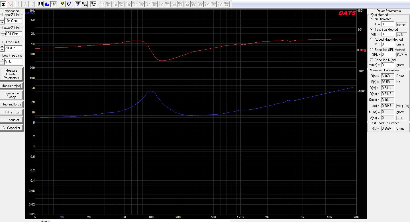

I've made a "test box" that is a replica of the real one, for testing purpose. I notice that with a slightly larger box (you can tell by the F(s)), braced as before, I don't have that "peak"
shouldn't be the opposite? I mean, if the box is not rigid, make it larger just increase the defects, but, based on the previous feedback, not now.
confused... maybe I need to test again the drivers in the main box...
Can you please point me to any documentation on how to understand box rigidity by the impedance curve? Can't find any :(

I can't be certain that the previous peak was due to wall flexing, but I think that unlikely. It might have been ripple.
However the new box is very resonant, with impedance ripples due to cabinet resonance at 750 Hz, 1 KHz, and 3.5 KHz. The first two are broad based and will be audible.
The impedance resonance of the speaker is still at 100 Hz.

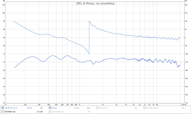

Phase
Same set up
Here is where I’ve really no idea if I’m right or not, and can’t find any good before/after example… every comment and links are more than welcome

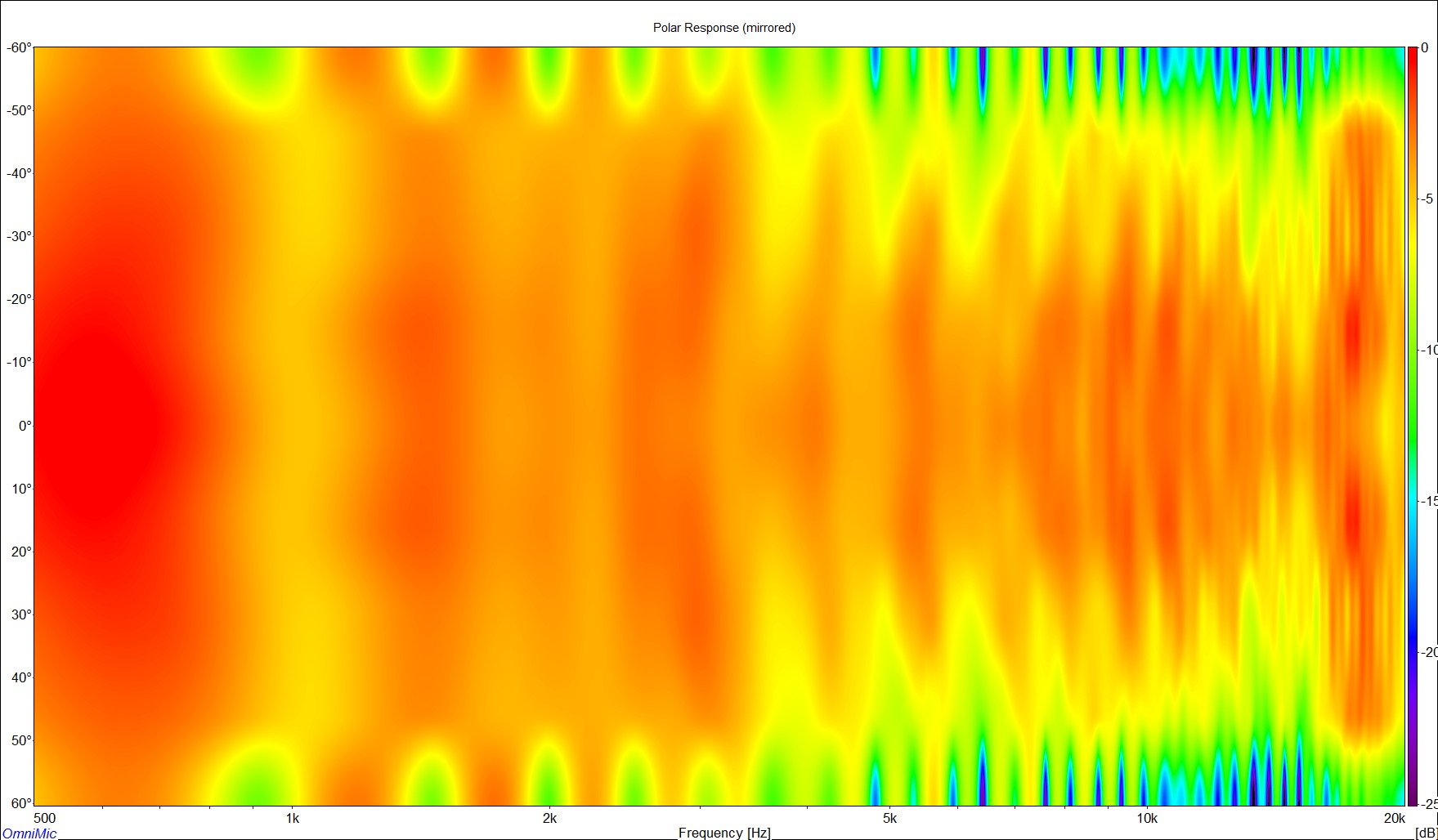

Off axis
Set up: 80dB, mic at 1 meter, indoor, gated
Purple: on axis
Red: 15 deg
Green: 60 deg
Do you think it’s ok?
Thanks in advance to everybody!

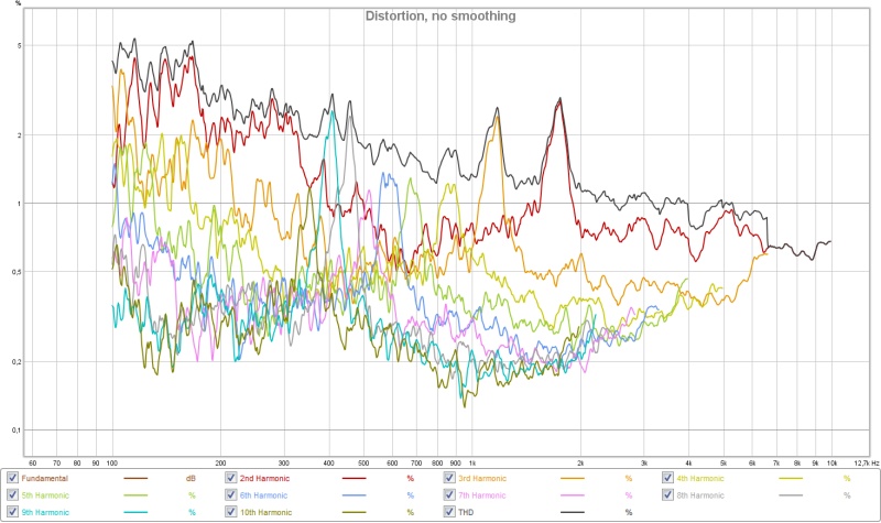

Dear Experts,
I would like to know your opinion on the final result that I got from my project. Below the FR, Phase, distortion and polar response
please note that they will be crosser over at 120Hz with the subs, and I'll refine the LF response in room
What do you think?
thanks in advance for all the comments!!
cheers
Dear Experts,
View attachment 22412 View attachment 22413 View attachment 22414
What do you think?
cheers
You have a nice mid band response, but it looks as if the response is falling off below 200 Hz.
