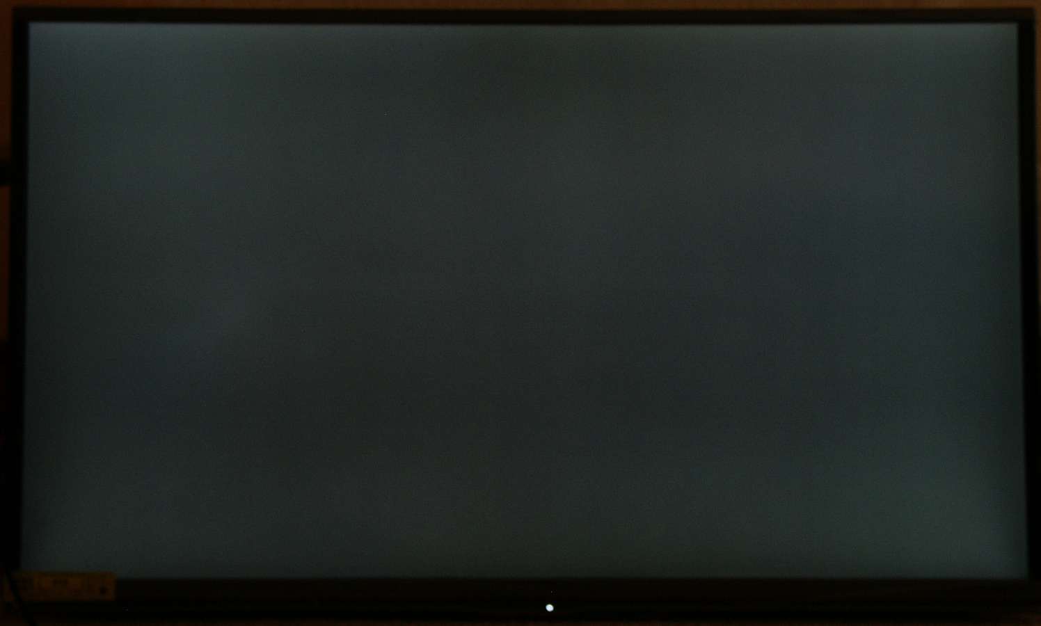

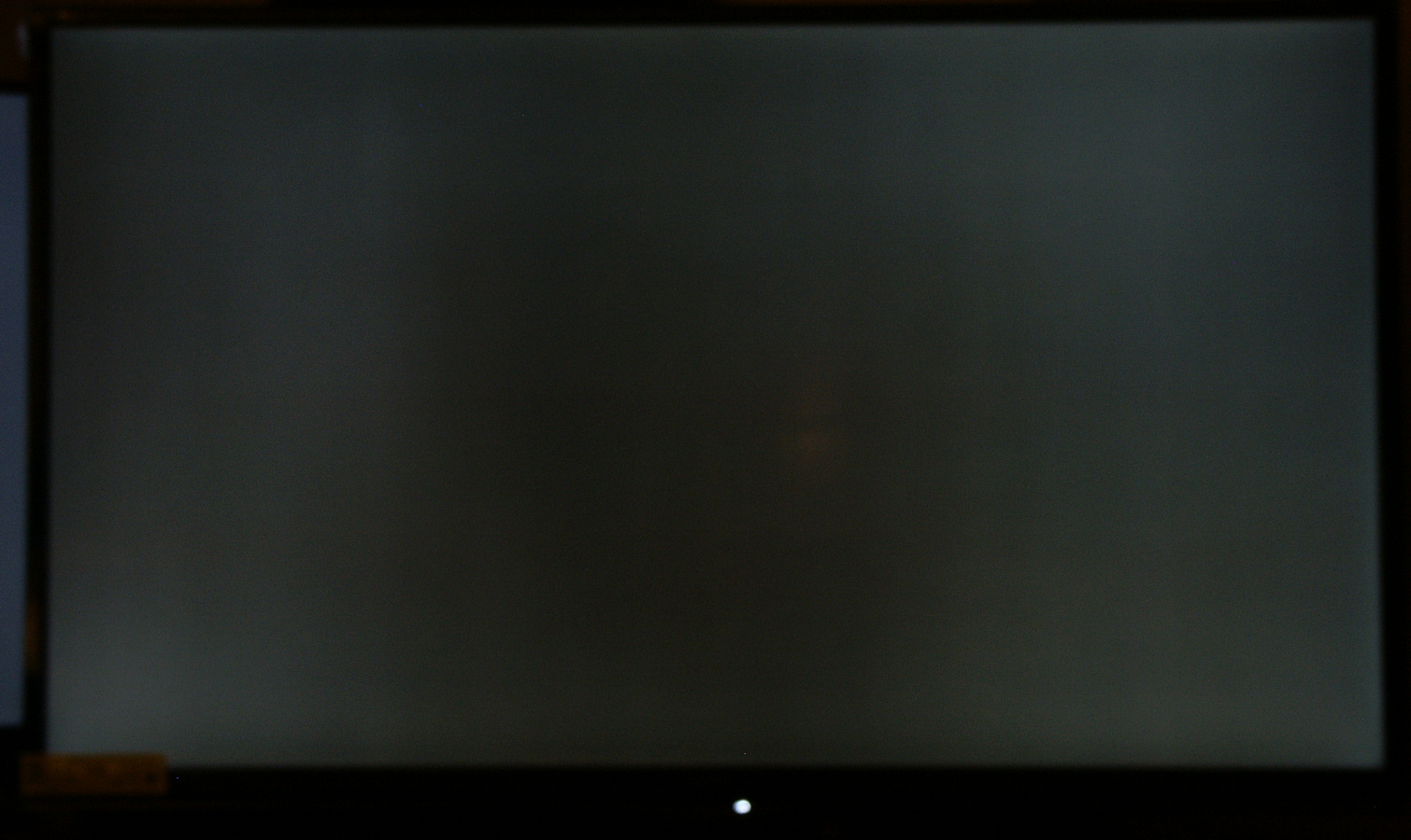

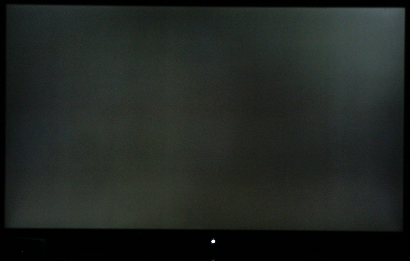

Sharp LE60EQ10U
Sharp has five model series for their 2014 LCD sets (note; LCD not LED);
LE, EQ, SQ & UQ series. The LE is a carryover from 2013 (it is a large step down from this model).
Not too many would try a third, let alone a fourth sample, but I did in the hopes the 4th was the winner. But, I lost again.
The 1st was the worst, by far. A dark area in the middle half of the panel. The 2nd & third better, but still bad with similar dark and light areas. The 4th was the best, but it still was not acceptable.
There is a obvious pattern to the uniformity issues. On all four, the center is the darkest and the rest varies widely. One has a hot spot in the upper right, another, the opposite corner; bottom left.
Not wanting to give up, I decided to try a SQ model which uses a slightly different panel. I wasn't interested in the extra so called 'features' and gimmicks, but just reasonably even uniformity. Well, it was better, actually the best of the bunch, but that was offset with a quirk in their "Resolution Enhance" settings.
When you switched from the default "Mode 1" to off, the gray scale shifted to a distinct greenish yellow. :confused: Apparently the set was aligned in that mode since it was mostly correct. Switching to Mode 2 cause no change, but turning that 'gimmick' (I took a close look at the differences on and off; (it basically is a edge enhancement setting in spite of what the hype says viewing static test patterns). Off clearly showed the problem
I did contact Sharp this time which was a positive experience. Their support for the larger sets is separate from the smaller models and it appears the support is in the US. After the 1st call, I received a call back the next day which I wasn't expecting looking for more details. I did send in numerous screen shots of both this problem and their panel problems (all sets). After the 2nd contact I had an e-mail and a call asking what I would like done. It was too late, the last set already went back since the time limit on the set I wound up keeping expired. It was more than obvious, this would not fly, even if this other quirk would be 'fixed'.
The odd thing about all of this is, Samsung uses Sharp panels on many of their models and on their 6350 model I wound up getting, it has almost no issues with poor uniformity. One reason may be that model uses direct lit (full array) vs edge lit. That and/or Sharps QC standards are far lower with their own sets.

1. Screen uniformity is the deal breaker. (see photos)

Edge lit vs FA (Full Array) backlighting uniformity issues;
I wanted to use a separate post to show these screen shots of what I am now calling "Sharps Black Hole". When I first saw the problem I didn't know what was going on. It was so severe, it was unwatchable (at lest for me.). The 4th set was almost as bad.
Taking a closer look at the Samsung (the one I wound up with) I saw a similar effect, but to a much. much lesser degree. In fact if I wasn't looking for it I would not of noticed.
Viewing most any of these VA LCD panels closer than what would be normal or recommended you will see a darker area in the center similar to these screen shots, but no way as bad. I didn't do this on the 55" Vizio IPS unfortunately, since it was already sent back so I don't know how that would of looked. This clearly reflects the very limited viewing angle. One reason it shows worse on these Sharps is the viewing angle is slightly narrower than most of the others.
There is a great site for seeing what I'm talking about if you don't already know. I already provided numerous links in the previous post.
For their 'viewing angle' tests, go here;
http://www.rtings.com/info/viewing-angle-tvs
The Vizio "M" model that was tested was the 55" IPS, not the 60", hence it had the widest viewing angle. (I have discussed that with him.)
I used a Sencore VP-403C HDTV/ATSC signal generator to produce a full frame, flat field. I used levels from 0 to 10 IRE for the tests since that is where the problems shows the easiest. The higher you raise the level, the problem usually diminishes above 40-50 IRE. Settings were left at viewing levels for a light controlled room, not home theater, but somewhat subdued living room lighting. Bright enough to read next to a table lamp. The problem would be much worse if it was darker. ;) Note, I was dead center for all shots and at the same distance as I would be when viewing (around 12').
I tried to be as consistent as possible between camera shots.
I did contact Sharp twice and had two return phone calls and three return e-mails which was a pleasant surprise. That and having the benefit of a separate support group for their large screen sets apparently based in the US was even more of a surprise. I did send these photos in to them and was told they would be forwarded to "management". I will give credit to what I would consider above average customer support from Sharp.
How can you NOT see this?? It was suggested that the problem be covered up by using some of the automatic features (gimmicks) that most turn off, but that would be no fix since all you would be doing is 'sweeping the dirt under the rug'. ;)
The first two are Vizio FALD, the 3rd is a Samsung, all the others are Sharp edge lit sets. Very easy to tell the difference with the Sharps.
