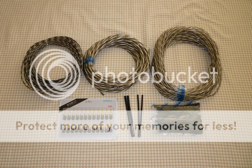

Agreed. The research will tell you how thick you need to go before you won't tell a difference...but only you can decide what you want. If you want 12 or 14 gauge, then by all means, go for it. There's more than just the audio reproduction that goes into enjoying a system. There's also the aesthetics, pride of ownership, and so forth. Just keep in mind that the thicker the wire, the less flexible it will be and the harder it is to route. I have some bare, white 16-gauge wires running to my surround speakers...and while they work just fine, they look kind of wimpy to me so I'm going to eventually swap them out for ones that I think look better. :)

Surprise surprise, Adam likes it big and thick :p
fuzz092888
fuzz092888
What? No comment about the color? :D
Leave it to Fuzz to pollute a perfectly good discussion on wire gauge and system performance... :p
I'm waiting to see what the color of the thicker stuff is. :D
fuzz092888
fuzz092888
I can't recall if the wire itself is a thicker gauge, but it'll have a thicker insulation and outer sheath.
So this tells me that you like it exotic and you don't care how thick it really is as long as you can put something on it make it feel thick.
Also, cool custom wire :)
