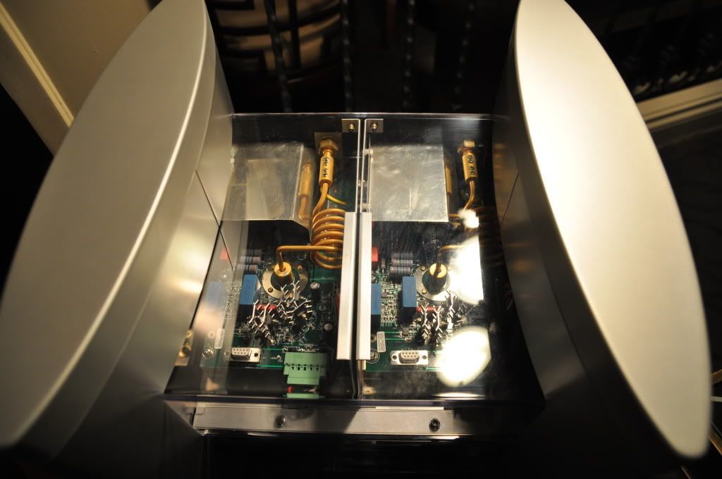

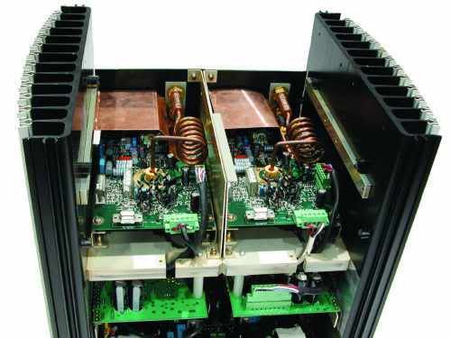

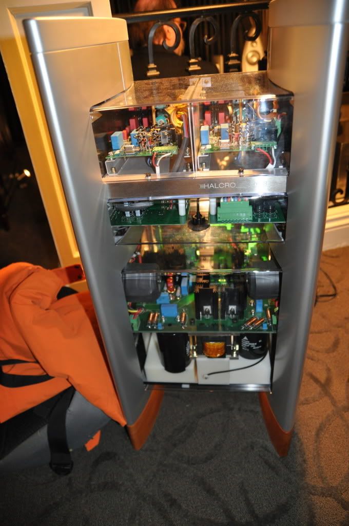

Halcro dm38 stereo amplifier. Less than 0.0007% distortion at full power. I'd love to take mine apart and look, but it would void my warranty, so I'll stick to the pics I found on Google.
-Brad

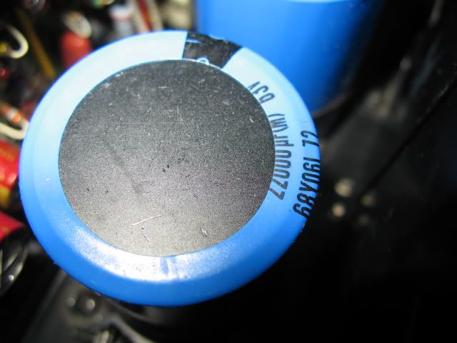

It isn't any juggernaut, but it is easy to see why the Adcoms of this period were so popular. Shielded transformer, and clean simple layout! I couldn't find info on transformer or Cap ratings. Comparing size to others, 11,000uF ea or 44,000uF total might be a decent guess.
This is the GFA-545 Mk II (100WPC):

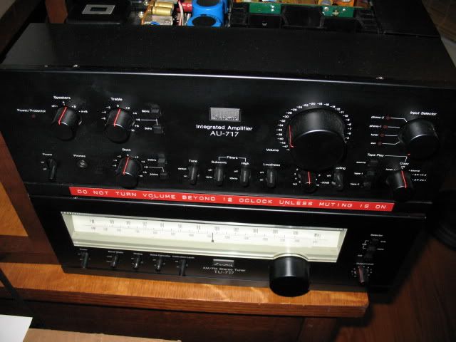

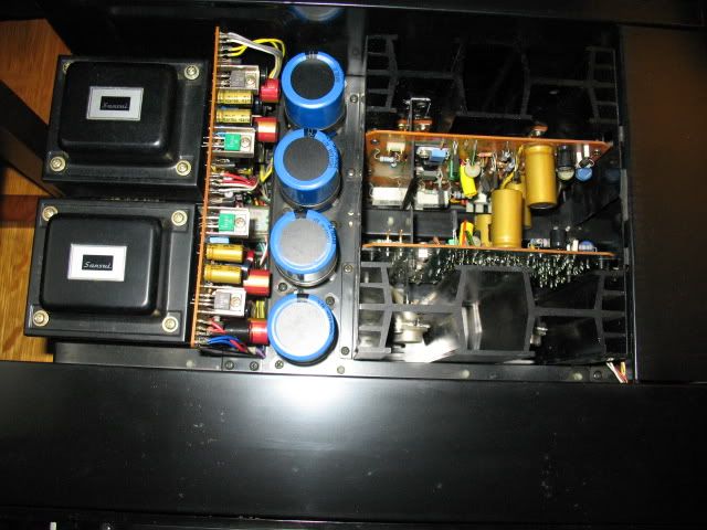

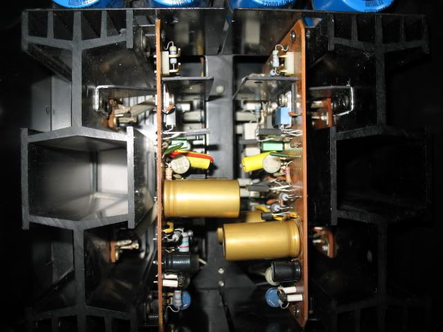

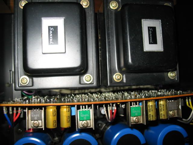

Sansui AU-717 bought new in 1980 (relative to my income, probably the most expensive thing I've ever bought that wasn't on a payment plan). Don't have the ratings on the transformers, but 88,000uF for the caps - Pretty stout for 85WRMS X 2:D
