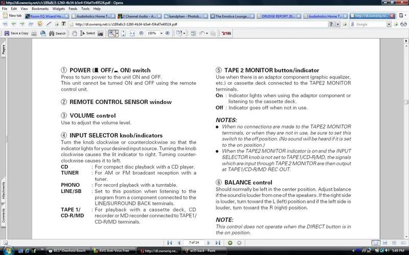

My first reaction was disappointment when I read the manual. The unit could not be turned on and off with the remote. That would mean either getting out of bed to turn it off or letting it run all night after we turned everything else off. I didn’t like either option so I decided to bring the receiver that drives my upstairs stereo system to the TV project and install the A-35R in that system in its place. After all, I never use the remote with that system anyway.

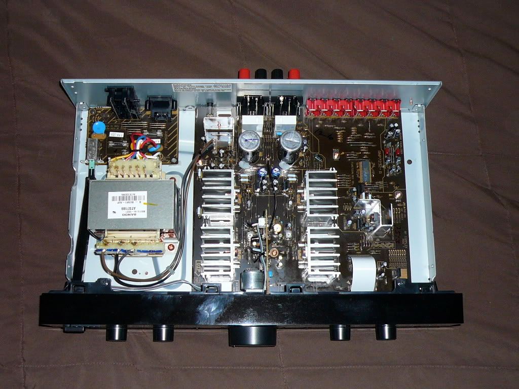

Are internal and rear pictures possible?

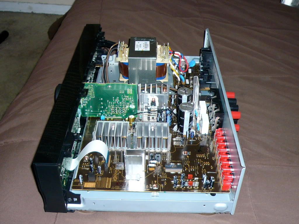

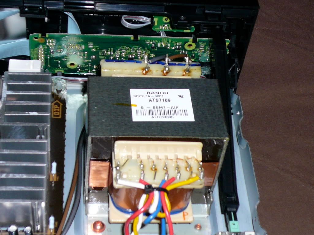

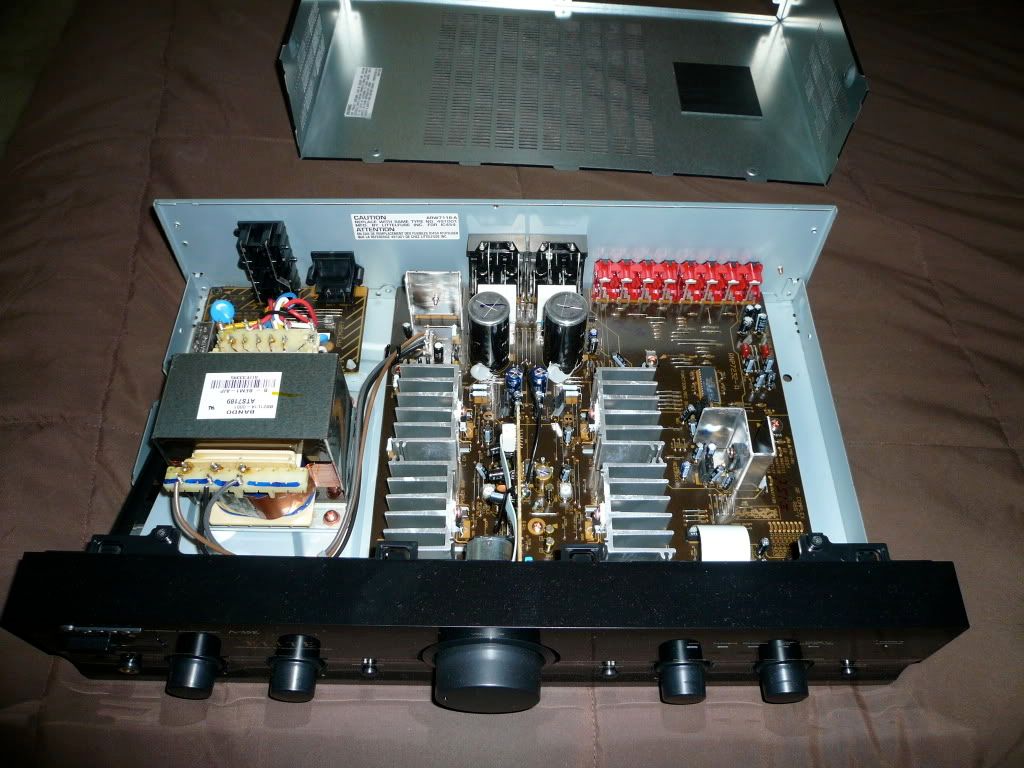

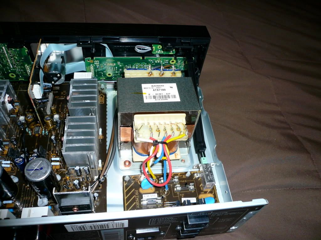

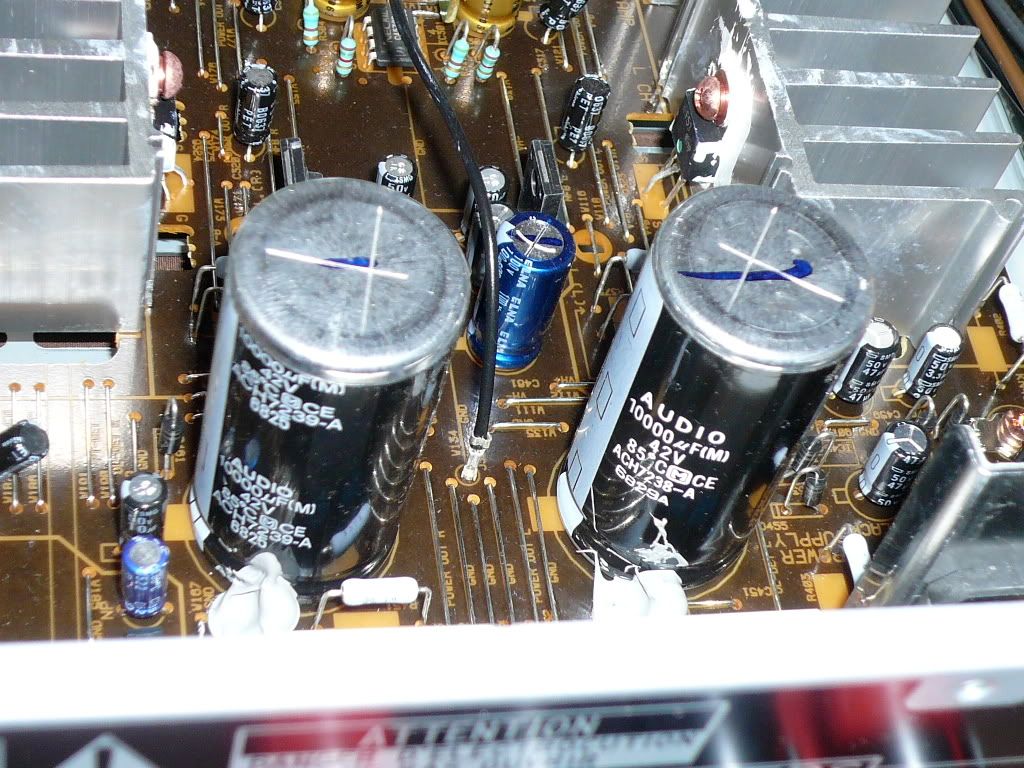

Default Pioneer A-35R Pictures

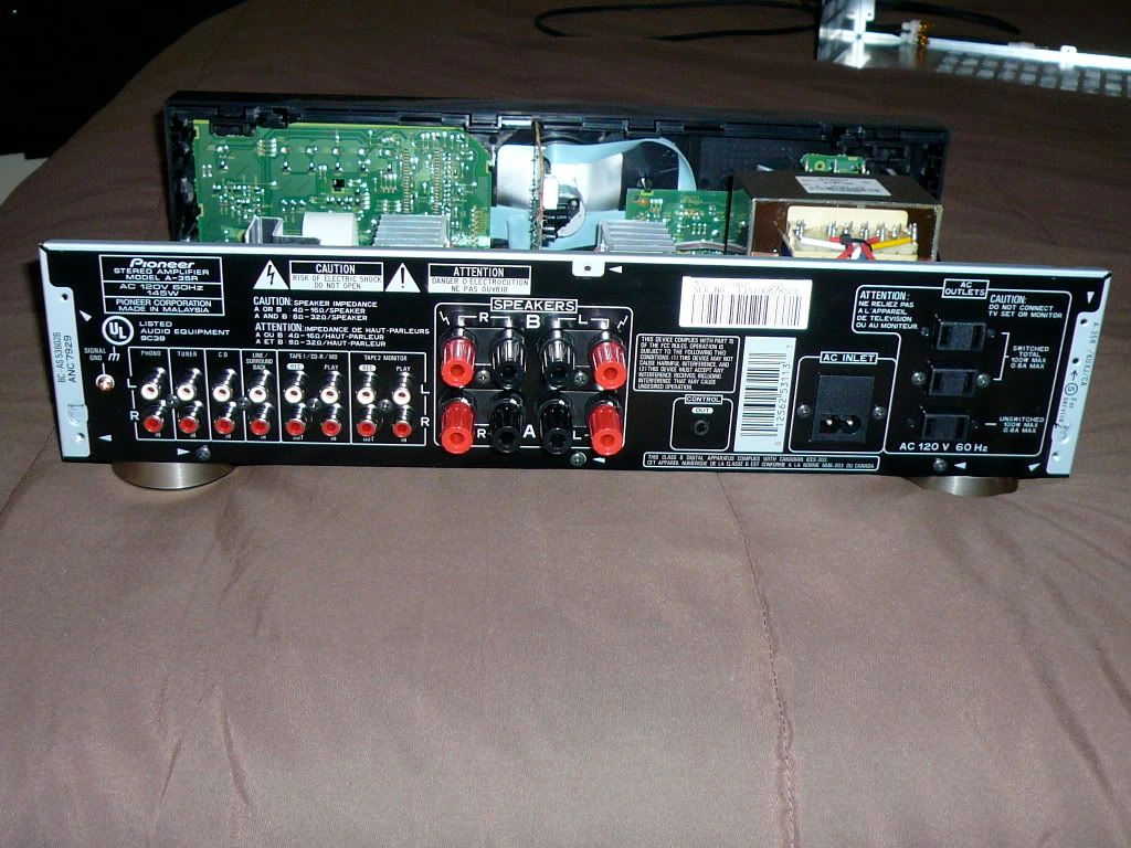

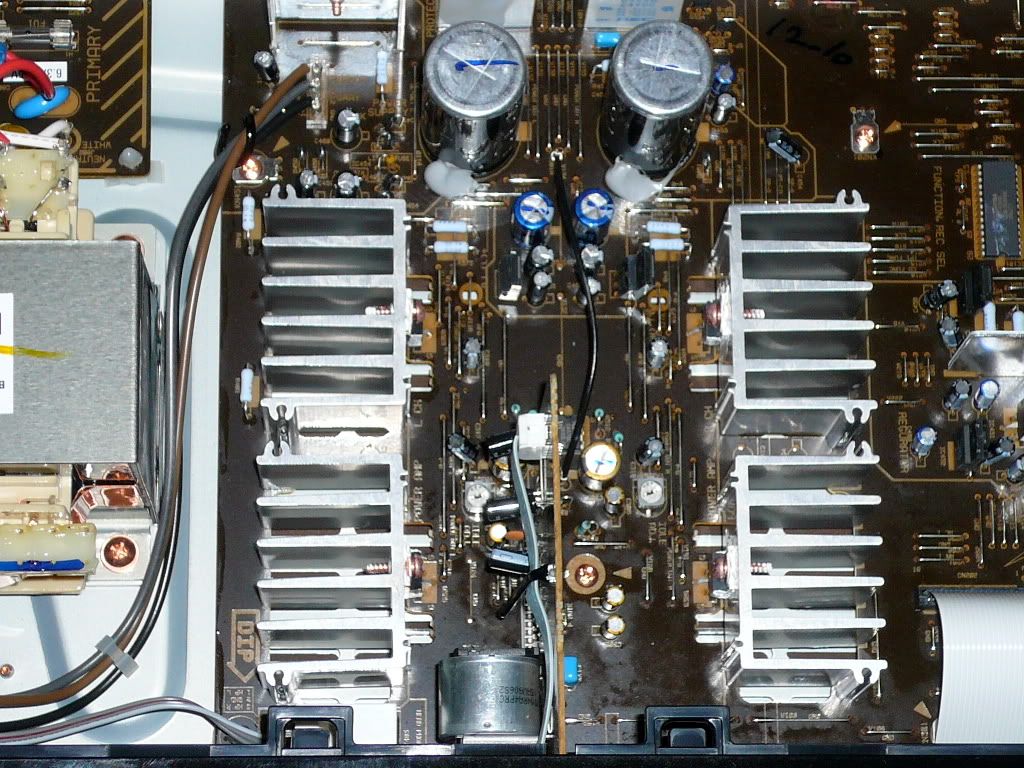

Here are some photos of the Pioneer A-35R Integrated Amplifier. The build quality is pretty good for a 179.00 amp that is stable into 4 ohms. I was impressed with the 4 individual heat sinks and rather large transformer for a 45 watt integrated amp. (65 watts into 4 ohms)

It does look like a solid piece of equipment. I love innard shots.

Thanks for posting those long awaited pics.

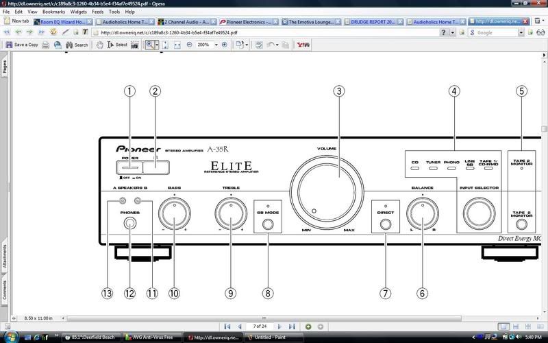

I know the unit has a tape/monitor inputs but does it have a loop function for an external crossover? The button on the far right looks like a monitor loop button but the pics I have seen online are very fuzzy.
