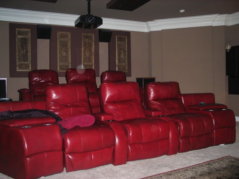

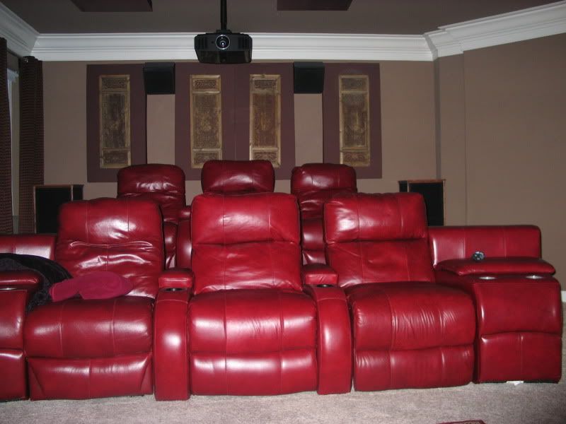

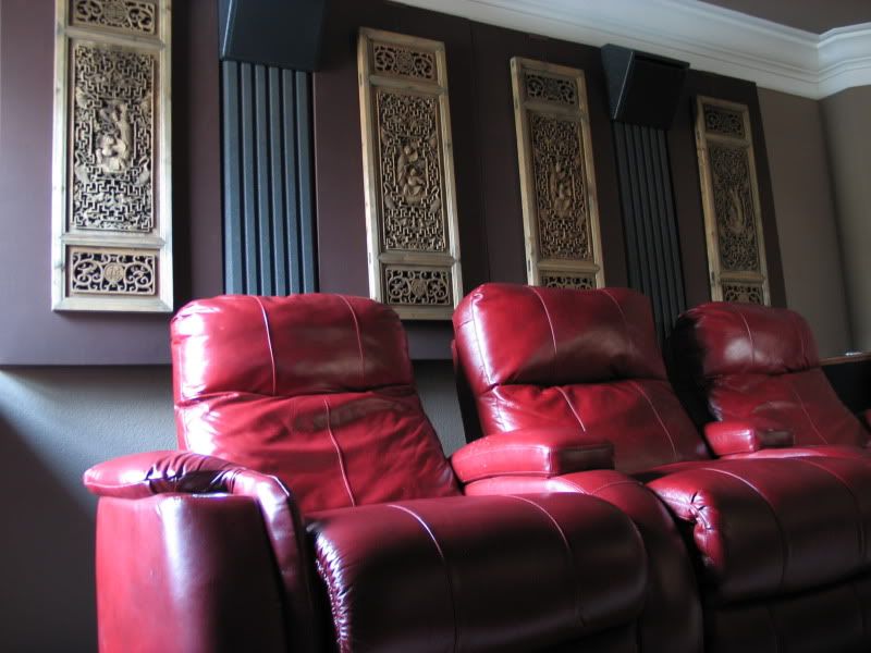

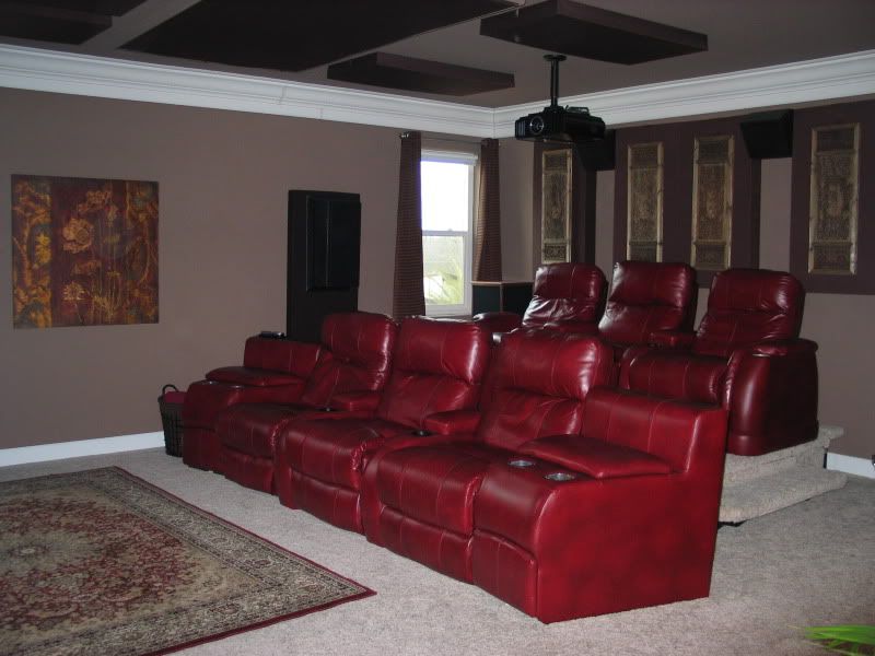

I have some bass traps coming that fit under the surround back speakers to complete the back wall. The SO just returned from shopping with a large wood painting that we hung on the now blank right wall. If the sun ever comes out again here in sunny California I'll take some pics.
There is a lot going on in there now but it is looking much better than the beige box it was when I first built it.;)
rmk
rmk

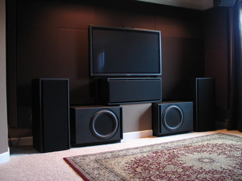

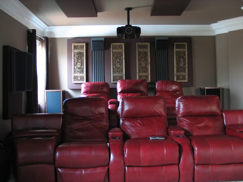

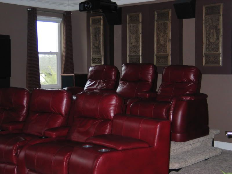

Some better pics (I cleaned the camera lens:p). The back wall bass trap diffuser experiment seems to be working out. I am liking what I hear but I'm sure quite a bit of the improved bass SQ is due to the Grammas. I would recommend that product to anyone with subs. I included the pic of the equipment closet mess to show the Wyred for Sound Amps.
Panels and a better look at the riser (you can just see a corner of one of the Danley TH-SPUD's in the back right corner of the riser). The gap there is intentional as that is the location of the horn subs mouth.

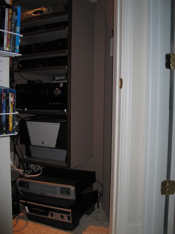

Captivators on the Great Grammas & equip closet
