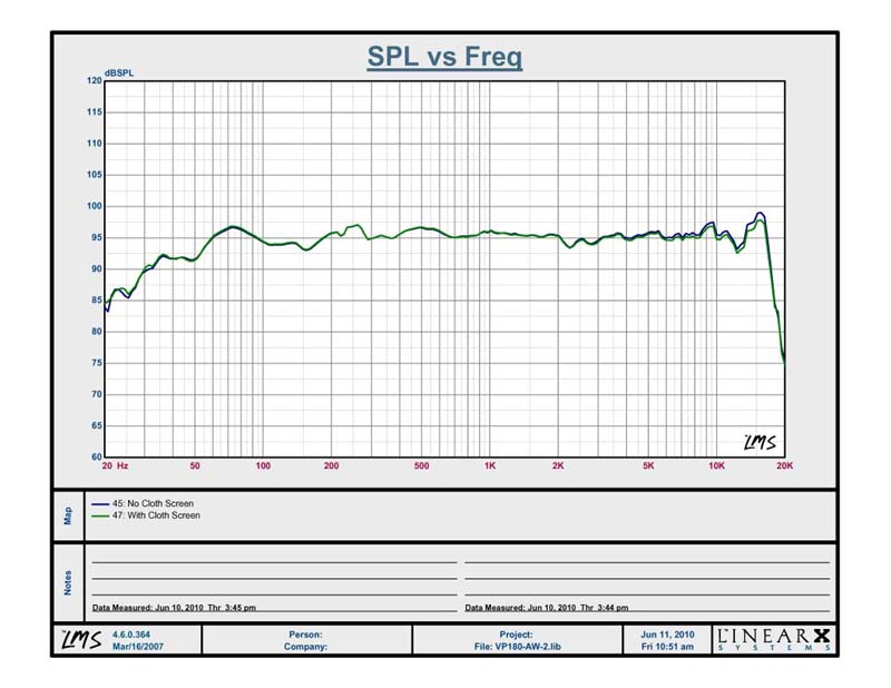

    This years annual visit to Axiom Audio brought about their announcement of their new V3 series of loudspeakers and running me through the ringer in their blind listening tests. Axiom conducts blind tests to reduce listener bias and ensure their product upgrades result in audibly provable results before making product changes. If you ever have a chance to personally visit Axiom Audio, I highly encourage you to bring along some music and request a blind listening session. Even if you decide which speaker sounds best to you within a few minutes, milk the experience and revel in the sonic delight.
