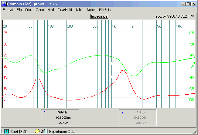

    The SS1s have 8 ohm impedance. And yes, they (that is my CAOW1s) are an easy load for any amp I've used including an old 30 wpc stereo receiver.
    For what its worth, the STs are nominally 4 ohms, but they are also a very easy load. I've driven mine with an old Denon HT receiver that does 70 wpc. Salk says any amp that delivers an honest 50 wpc will drive them. I have heard STs nicely driven by a 30 wpc tube amp. So even though I now use a 200 wpc amp for them, STs are an easy load than most any HT receiver can drive.
    This is an impedance curve for the STs, red is impedance in ohms and green is impedance phase in degrees. It can be found here. They go as low as 4 ohms, but never lower.
